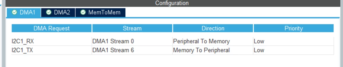

I try to read and write data to a sensor via i2c with DMA1 in an STM32 Nucleo F401 board where a FreeRTOS is running.

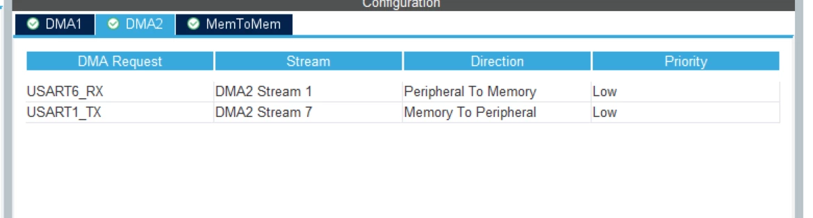

I can read the sensorata with polling methode, and next to the I2C an UART is running with the DMA2 correctly. I have checked and the MX_DMA_Init is running before the MX_I2C1_Init.

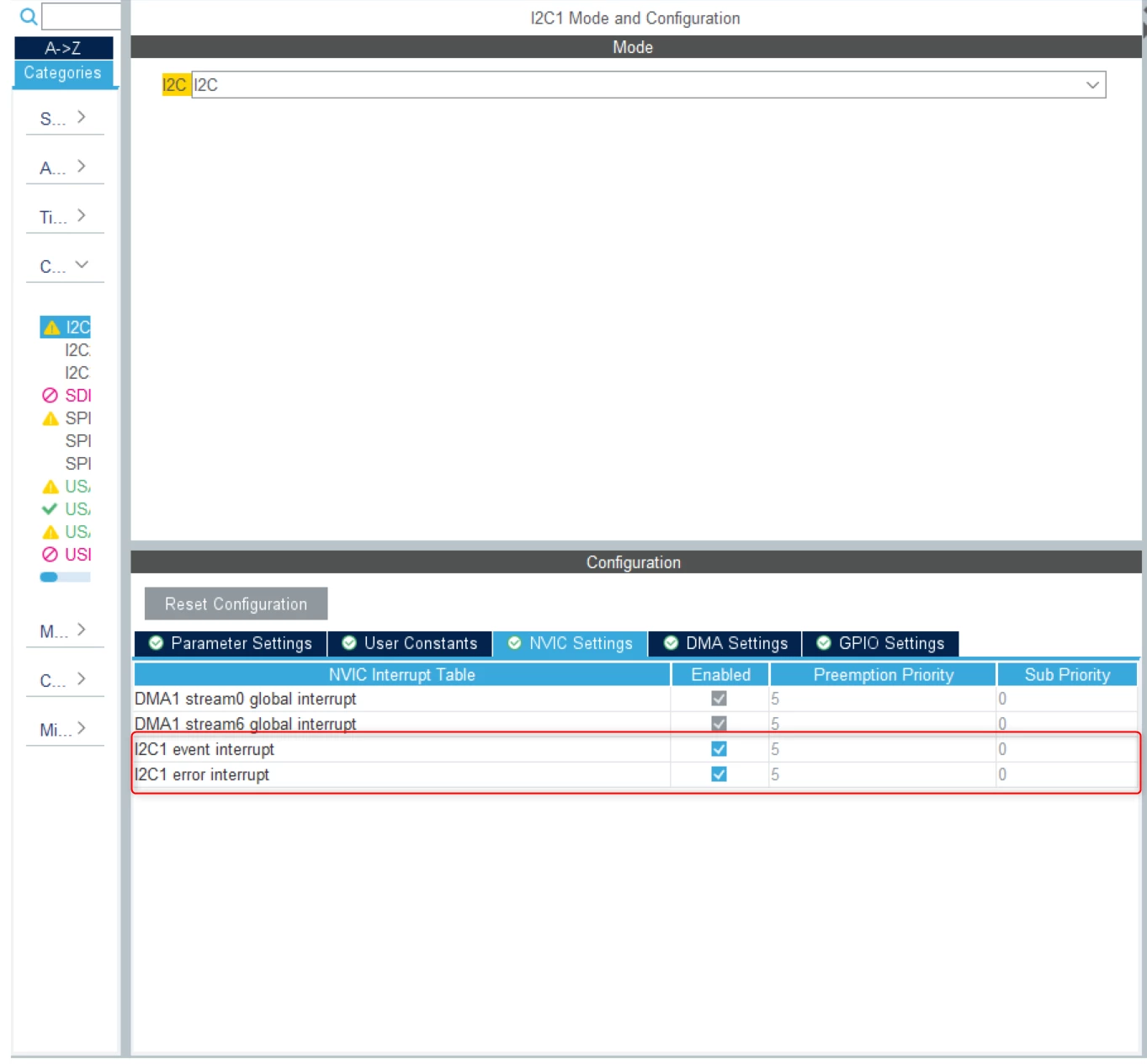

When I try to write to the sensor as a master with DMA(HAL_I2C_Master_Transmit_DMA) with the "i2c1 event interrupt" and "i2c1 error interrupt" disabled in the FreeRTOS the parattet tasks are just running fine just the callback HAL_I2C_MasterTxCpltCallback is not triggered.
And when i am enabling the" i2c1 event interrupt" and "i2c1 error interrupt" from the CubeMX two parallel task in the Free rtos are running at once and then no more parallel schedulling is happening and the HAL_I2C_EV_IRQHandler function is called periodically and leaving the function in the last else branch where the /* Do nothing */ is commented.
Could you please suggest what could i try to use the i2c with DMA?

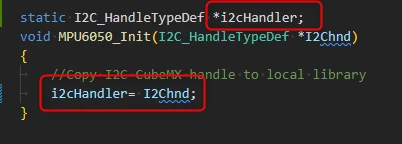

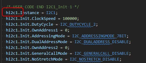

Finally found the solution. I summarise some issues I had:
HAL_I2C_Master_Transmit_DMA(i2cHandler, MPUADDR, i2cData, 2);
  1. The Deliverable data: The deliverable data must be global variable for DMA, otherwise when I am leaving the function/ or calling a destructor of the object the memory is freed and the DMA aburts.
  2. The delivery target in my case the i2cHandler must not be the copy of the original structure/objetc, because the callback function addresses are checked from parallel interrupts based on the original object and updated in the caling HAL_I2C_Master_Transmit_DMA function. If incorrect ending up in a loop in the HAL_I2C_EV_IRQHandler because teh hi2c->XferISR is alvais NULL.
What to check: If the I2C handler is exacly the same in the interrupt handler from the function or the name is different, but the new one only uses a pointer to the old one. In my case thy where not the same from the myin called hi2c1 and the function i2cHandler.
The solution for me was to use the copy of the pointer only not the contant of the hendler.0693W00000YAX7LQAX.png3. With the STM32 H7 boards there is a memory allocation issue which is explaind with the solution in the below article.

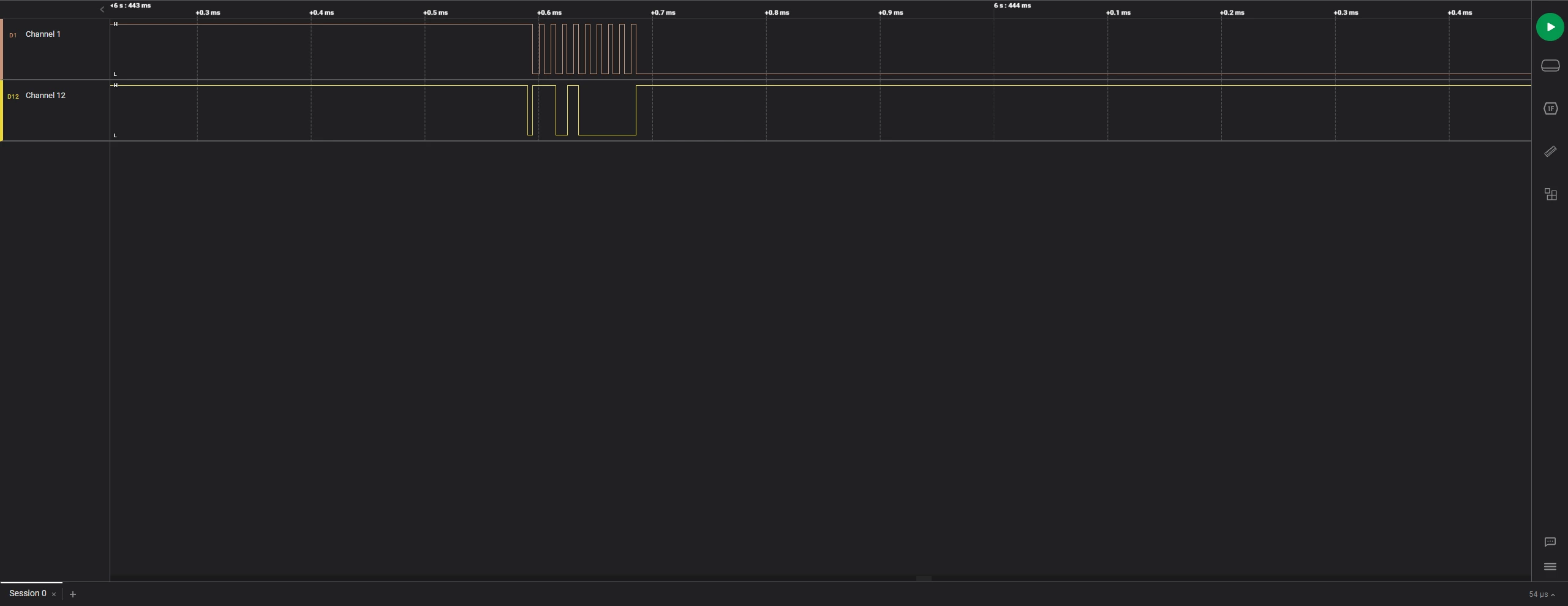

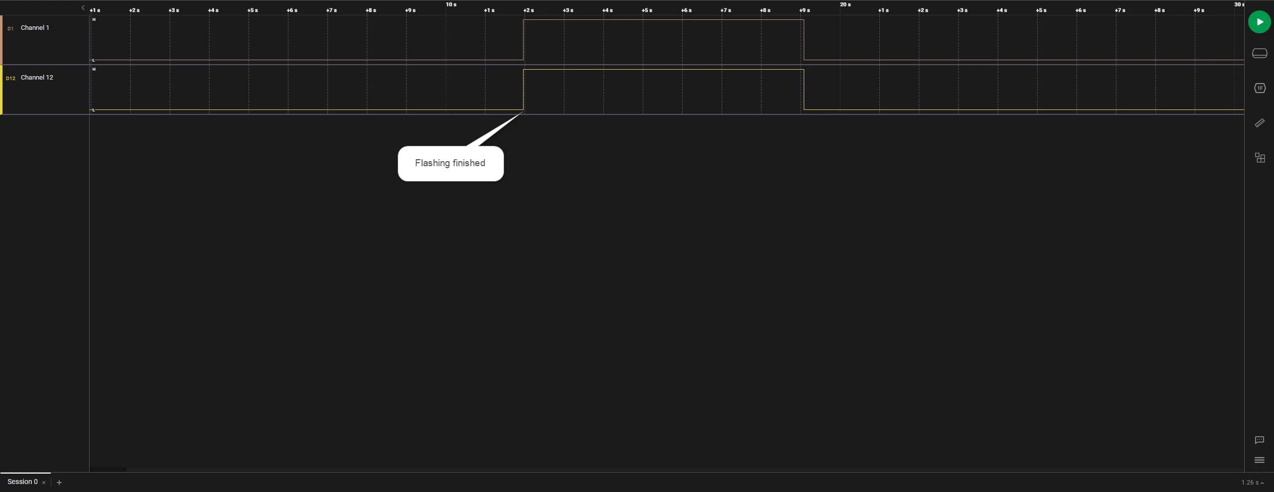

Hi @KHALSI_Foued​ ,
Thank you for your replay, i changed the Pull-up/Pull-down to Pull-up. But it did not helped unfortunately.
I attached a capture with a Logic analyser. I am trying to get the error flag status.
The I2C_DMAError function is not called. And from the registers the fault masks is 0.

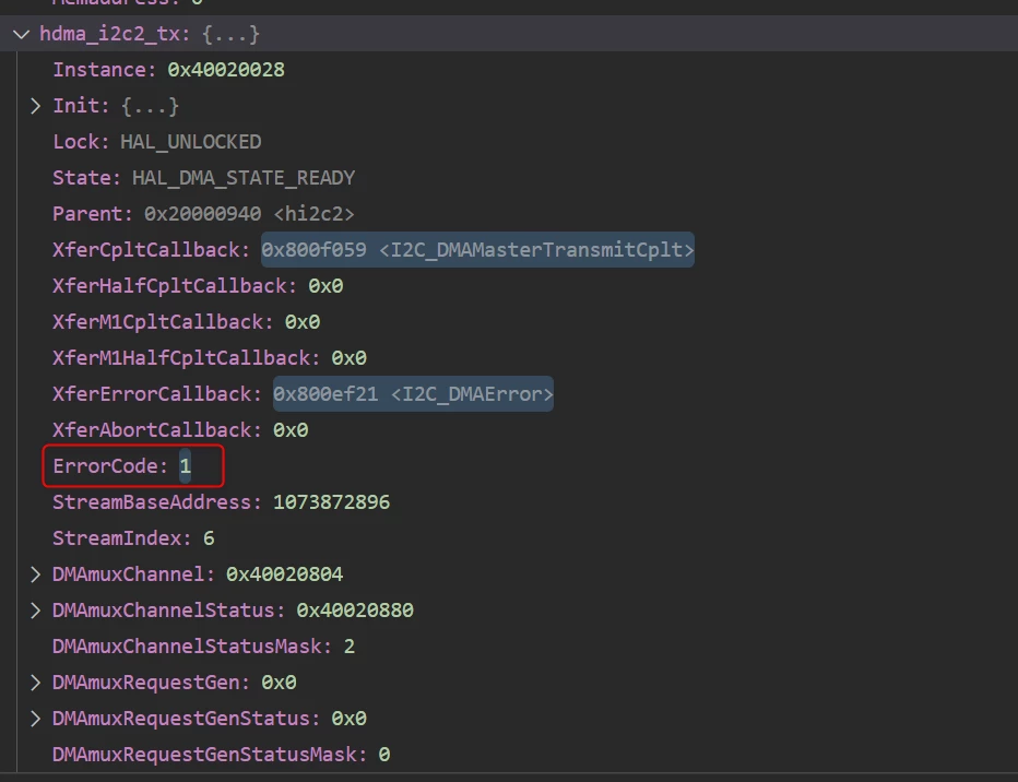

I Switch to a different device a Nucleo-H723ZG whwre at least the DMA transfer starts.
0693W00000YAWScQAP.pngBut happenes only for 1 cycle and the DMA failes with error code 1. What is the Transfer error.
#define HAL_DMA_ERROR_TE              (0x00000001U)    /*!< Transfer error                          */ 0693W00000YAWSrQAP.pngMy code now looks like this:
