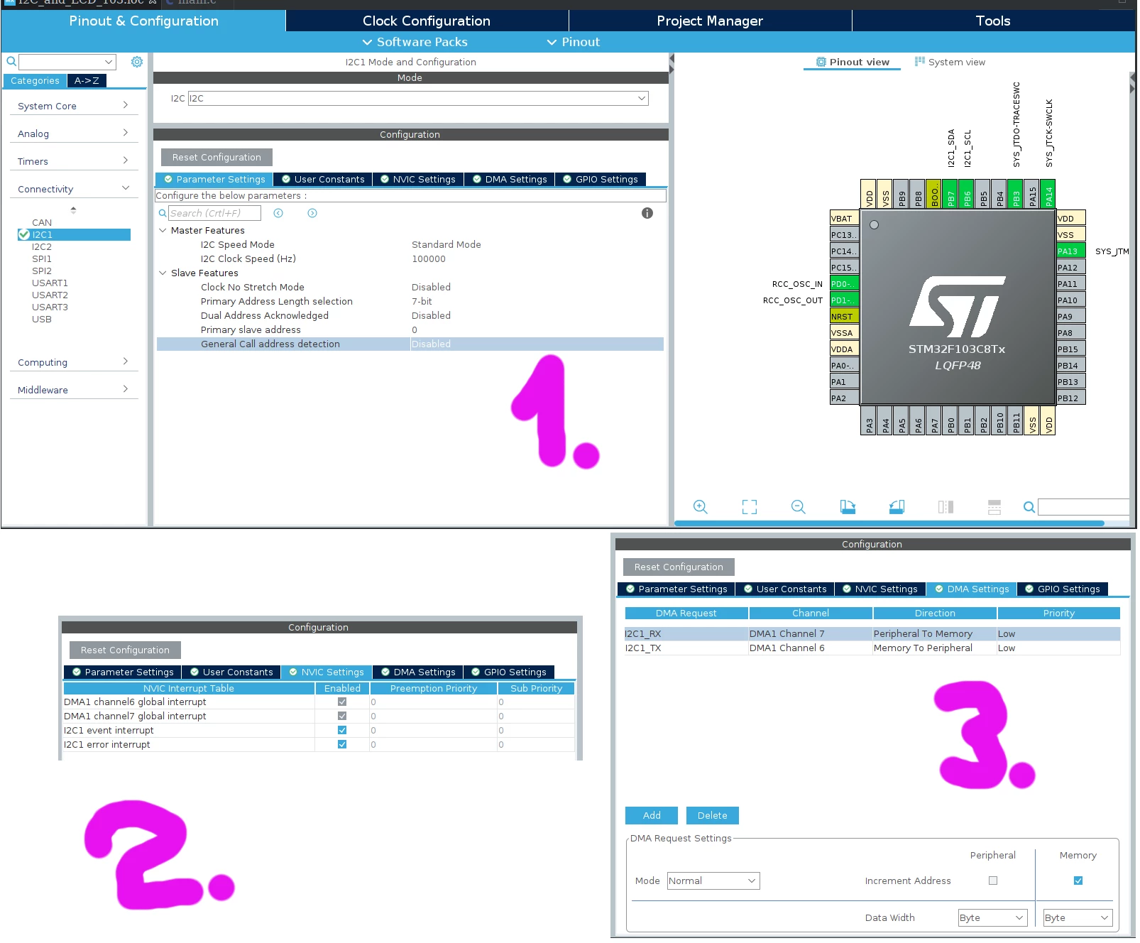

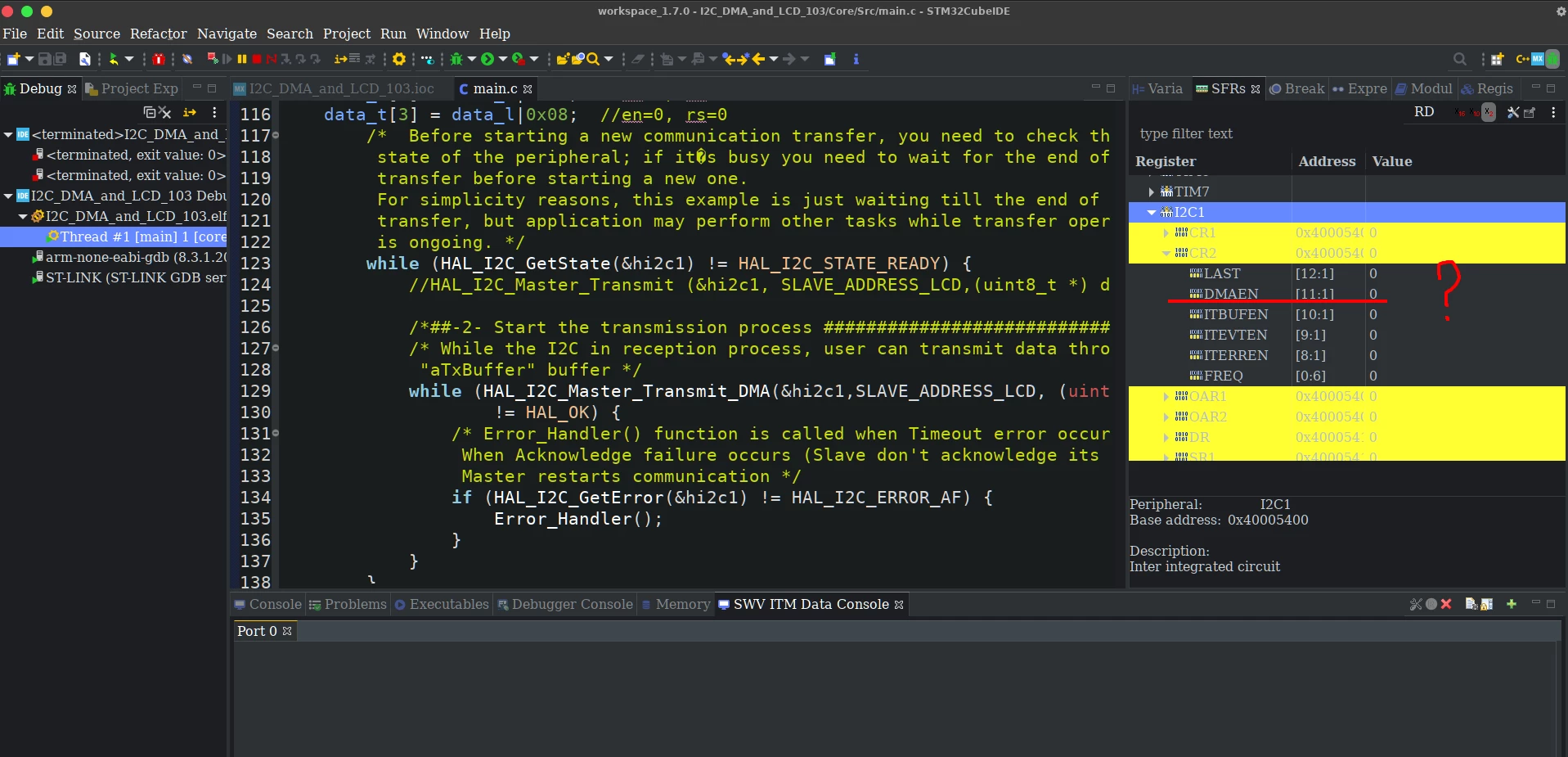

I am a beginner and learning I2C DMA, could you tell me what I'm doing wrong?
I connected the LCD to Blue Pill and it works fine with function "HAL_I2C_Master_Transmit" i.e. without DMA!
But, when DMA is configured, it is dosn't works!
Very simple code, but I can not find a mistake!
Link to my main.c https://pastebin.com/cz7b2Bbu

You need to wait for the transfer to complete before starting another DMA transfer. You can do so by polling the state of the handle.
You should always monitor the return status from HAL_* to verify it succeeds (HAL_OK).

Thanks for answers! I rewrote my code according to the example, but something does not work! Link to my new main.c https://pastebin.com/BvDa3ivg
DK.7
DK.7Author
September 16, 2021
I found my mistake, one more time THANK YOU!
my code now https://pastebin.com/yP56NqX8
