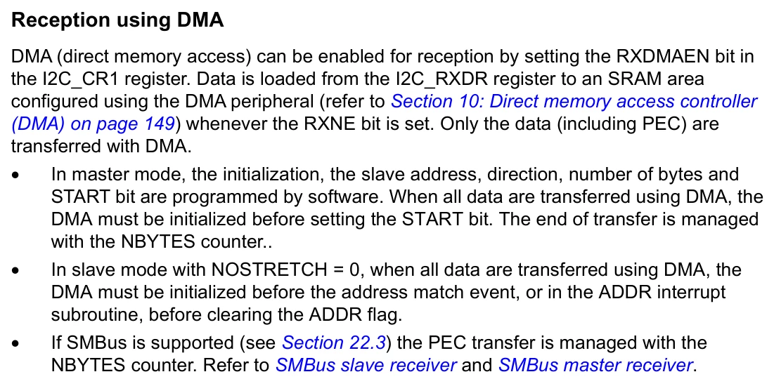

The reference manual also has instructions on how to do things with direct register access. Doesn't look like you enable RXDMAEN (or TXDMAEN) in the CR1 register anywhere.

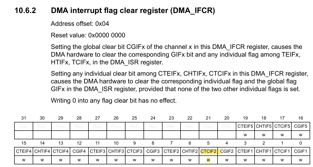

> DMA1->IFCR |= DMA_IFCR_CTCIF2; // Clear transfer complete flag
This clears all flags, not just TCIF2. You want:
DMA1->IFCR = DMA_IFCR_CTCIF2;
 Presumably the other flag got cleared by one of these statements causing the mcu to wait forever.
Edit: not so sure of this anymore, but in any case, IFCR should not be read, only written.
tableAuthor
Dec 22, 2024 6:16 PM UTC
Do you perhaps mean "IFCR should not be 'Written", only "Read"?
I am not sure I understand the issue otherwise?
I am actually having a hard time finding this datasheet that actually shows the registers and not the short version of it.
So I can not see which flag in the register I actually have to reset.
Also the DMA_IFCR_CTCIF2 translates into "(0x1UL << (5U))"
Also the DMA_IFCR_CTCIF3 translates into "(0x1UL << (9U))"
If I = it then it will overwrite all of the register... Is that what I want?
After changing this in both instances of setting DMA1->IFCR it still did the same.
DMA1->IFCR = DMA_IFCR_CTCIF2; // Clear transfer complete flag
DMA1->IFCR = DMA_IFCR_CTCIF3; // Clear transfer complete flag
Thanks

From the RM, you can see the register is write-only:
I figured.
