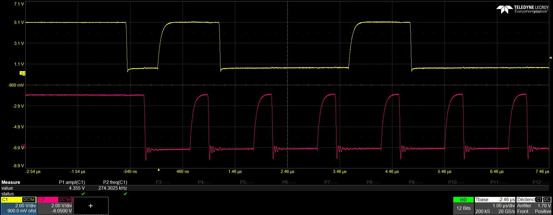

This is a visualize simultaneously signals on clock and data lines , I notice a desynchronization between the data
and the clock, it seems as if its the source of my problem, data frames are not cached due to this  is that correct ?
As for signals shapes, i think there is no problem related to Pullups, what do you think?

Andrew Neil
November 18, 2024
Is that before or after the isolator?
Again, does it work without the isolator?
MnfzAuthor
November 19, 2024
It's after the isolator, i will join the waves from test points before the isolator.
As for tests,  i don't have an INA228 that i can connect directly to my stm32 to check if its an isolater issue..
