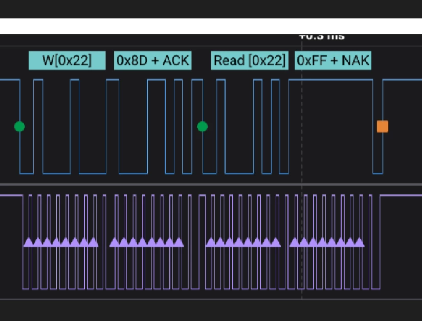

I have come across an odd situation in I2C communication between F405 and sensors
1) F405 is master. address is 7 Bit
2) with 3 slave I2C sensors , address, 22h,35h,78h
3) There is no issue to read data from sensors of 22h and 35h

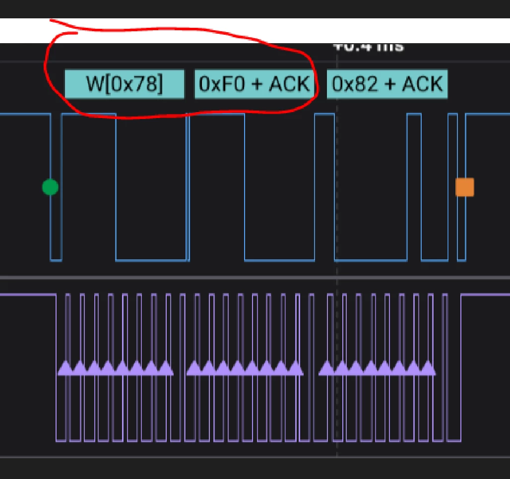

but when communicate with 78h. after sending address 78h. another byte F0h is sent
The F0h is not expected.

The extra 0xf0 looks like the FIRST byte of a 10-bit address, but obviously not appearing as the first byte. May just be a coincidence.

The reason is probably that it will be 0xF0 after shifting 0x78 +0 (write). The 0xF0 may cause confusing between 7bit and 10 bit address.
