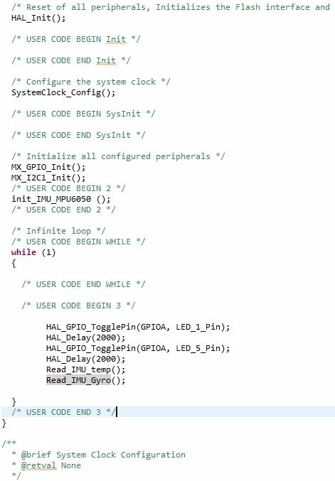

ok sorry i will send you :
Main.c :
/* USER CODE BEGIN Header */
 * @file : main.c
 * @brief : Main program body
 * @attention
 * Copyright (c) 2024 STMicroelectronics.
 * All rights reserved.
/* USER CODE END Header */
#include "main.h"
#include "STM332_IMU.h"
/* USER CODE END Includes */
/* USER CODE BEGIN PTD */
/* USER CODE END PTD */
/* USER CODE BEGIN PD */
/* USER CODE END PD */
/* USER CODE BEGIN PM */
/* USER CODE END PM */
extern I2C_HandleTypeDef hi2c1;
/* USER CODE BEGIN PV */
/* USER CODE END PV */
static void MX_I2C1_Init(void);
/* USER CODE BEGIN PFP */
/* USER CODE END PFP */
/* USER CODE BEGIN 0 */
/* USER CODE END 0 */
 * @brief The application entry point.
 * @retval int
int main(void)
 /* USER CODE BEGIN 1 */
 /* USER CODE END 1 */
 HAL_Init();
 /* USER CODE BEGIN Init */
 /* USER CODE END Init */
 SystemClock_Config();
 /* USER CODE BEGIN SysInit */
 /* USER CODE END SysInit */
 MX_GPIO_Init();
 MX_I2C1_Init();
 /* USER CODE BEGIN 2 */
 init_IMU_MPU6050 ();
 /* USER CODE END 2 */
 /* Infinite loop */
 /* USER CODE BEGIN WHILE */
 while (1)
 /* USER CODE END WHILE */
 /* USER CODE BEGIN 3 */
		 HAL_GPIO_TogglePin(GPIOA, LED_1_Pin);
		 HAL_Delay(2000);
		 HAL_GPIO_TogglePin(GPIOA, LED_5_Pin);
		 HAL_Delay(2000);
		 Read_IMU_temp();
		 Read_IMU_Gyro();
 /* USER CODE END 3 */

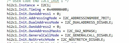

 /* USER CODE BEGIN I2C1_Init 0 */
 /* USER CODE END I2C1_Init 0 */
 /* USER CODE BEGIN I2C1_Init 1 */
 /* USER CODE END I2C1_Init 1 */
 hi2c1.Instance = I2C1;
 hi2c1.Init.Timing = 0x40000A0B;
 hi2c1.Init.OwnAddress1 = 0;
 hi2c1.Init.AddressingMode = I2C_ADDRESSINGMODE_7BIT;
 hi2c1.Init.DualAddressMode = I2C_DUALADDRESS_DISABLE;
 hi2c1.Init.OwnAddress2 = 0;
 hi2c1.Init.OwnAddress2Masks = I2C_OA2_NOMASK;
 hi2c1.Init.GeneralCallMode = I2C_GENERALCALL_DISABLE;
 hi2c1.Init.NoStretchMode = I2C_NOSTRETCH_DISABLE;
 if (HAL_I2C_Init(&hi2c1) != HAL_OK)
 Error_Handler();
 /** Configure Analogue filter
 if (HAL_I2CEx_ConfigAnalogFilter(&hi2c1, I2C_ANALOGFILTER_ENABLE) != HAL_OK)
 Error_Handler();
 /** Configure Digital filter
 if (HAL_I2CEx_ConfigDigitalFilter(&hi2c1, 0) != HAL_OK)
 Error_Handler();
 /* USER CODE BEGIN I2C1_Init 2 */
 /* USER CODE END I2C1_Init 2 */

now it compiles properly i ve corrected something. But i haven't anything on i2c lines.

In your main.c you don't change I2C_HandleTypeDef hi2c1; but leave it as is.
You only add extern I2C_HandleTypeDef hi2c1; to your files that use the HAL I2C API's
