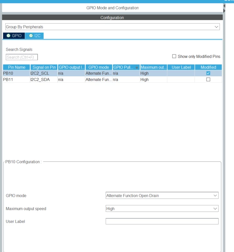

Hello everyone,
I want to configurate the I2C channels as pull-up in STM32CubeIDE for STM32F103C8T6, but I couldn't set it.
It looks like in the attached image. It just shows n/a in configuration.
How I set it as pull-up?
Please inform me. Thanks.

    The internal pull-ups are not suitable for use as I2C bus pull-ups - you need to use external pullups.

    Internal pull-ups are not recommended for I2C. Pull-ups must be adapted to the I2C bus speed and to the bus load.

    i just tried , yes, on F103 no pullups to set , only n/a .
    But on F401 i tried also, here pullups possible :
    So for pullups - take another cpu . :)

    Or just use the proper external pullups - the internal ones (when available) are likely to be too large.
