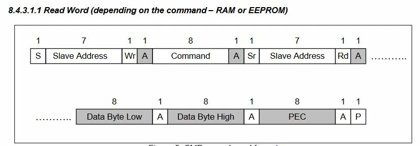

From the data sheet, follow is the algorithm
https://cloud.githubusercontent.com/assets/5645667/26305867/06c1de46-3f2c-11e7-9dad-d3fda7dce60a.png
Therefore in order to support repeat start, I see that I can use HAL_I2C_Master_Transmit/Receive_IT() API's

    Hello!!
    According to the ''From the data sheet, follow is the algorithm'' above figure,
    The code is like this.

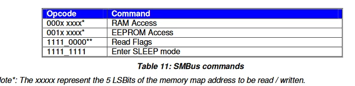

    char cmd=0x07; // RAM access address 07 TOBJ
    char readbuf[3]={0,0,0};// send start bit, send slave address, send write bit, send command
    HAL_I2C_Master_Sequential_Transmit_IT(&hi2c2, 0x5A << 1, &cmd, 1, I2C_FIRST_FRAME);
    while (HAL_I2C_GetState(&hi2c2) != HAL_I2C_STATE_READY);
    //send rep start bit,send slave address, read three bytes with acks(dont care for now, about pec), and stop bit
    HAL_I2C_Master_Sequential_Receive_IT(&hi2c2, 0x5A << 1, readbuf, 3, I2C_LAST_FRAME);
    while (HAL_I2C_GetState(&hi2c2) != HAL_I2C_STATE_READY);�?�?�?�?�?�?�?�?�?�?�?�?�?�?�?�?�?�?�?�?�?�?�?�?�?�?�?�?�?�?�?�?�?�?�?�?�?�?�?

    Hello.
    'I am assuming internally, this API sends the data to I2c in the following form (start bit - slave address - writebit - command)' Yes it is true but it not sends a stop bit.
    HAL_I2C_Master_Transmit_IT(), sends a stop bit after transaction. this is the difference.
    Read the the coments the file stm32f0xx_hal_i2c.c You will find all the info about theese fuctions Check the pullup resistors check the voltage of sensor, is 3.3v? Is your device's address the default 0x5A ? Is your code correct initialised with I2C interrupts enabled? When this function stucks:
    while(HAL_I2C_GetState(&hi2c2) != HAL_I2C_STATE_READY);
    try to put a breakpoint at I2Cx_IRQHandler, to find the cause of error.
