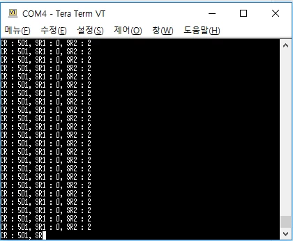

But, I got always busy flag on I2C_SR2 register

SR2's busy flag always set.
How I can solve it?

    I have a hard time in 2 days. OMG.. It just a shift probelm..
    I should like this.
    RCC_AHB1ENR |= 1 << GPIOBEN;
    but i did
    RCC_AHB1ENR |= GPIOBEN;
