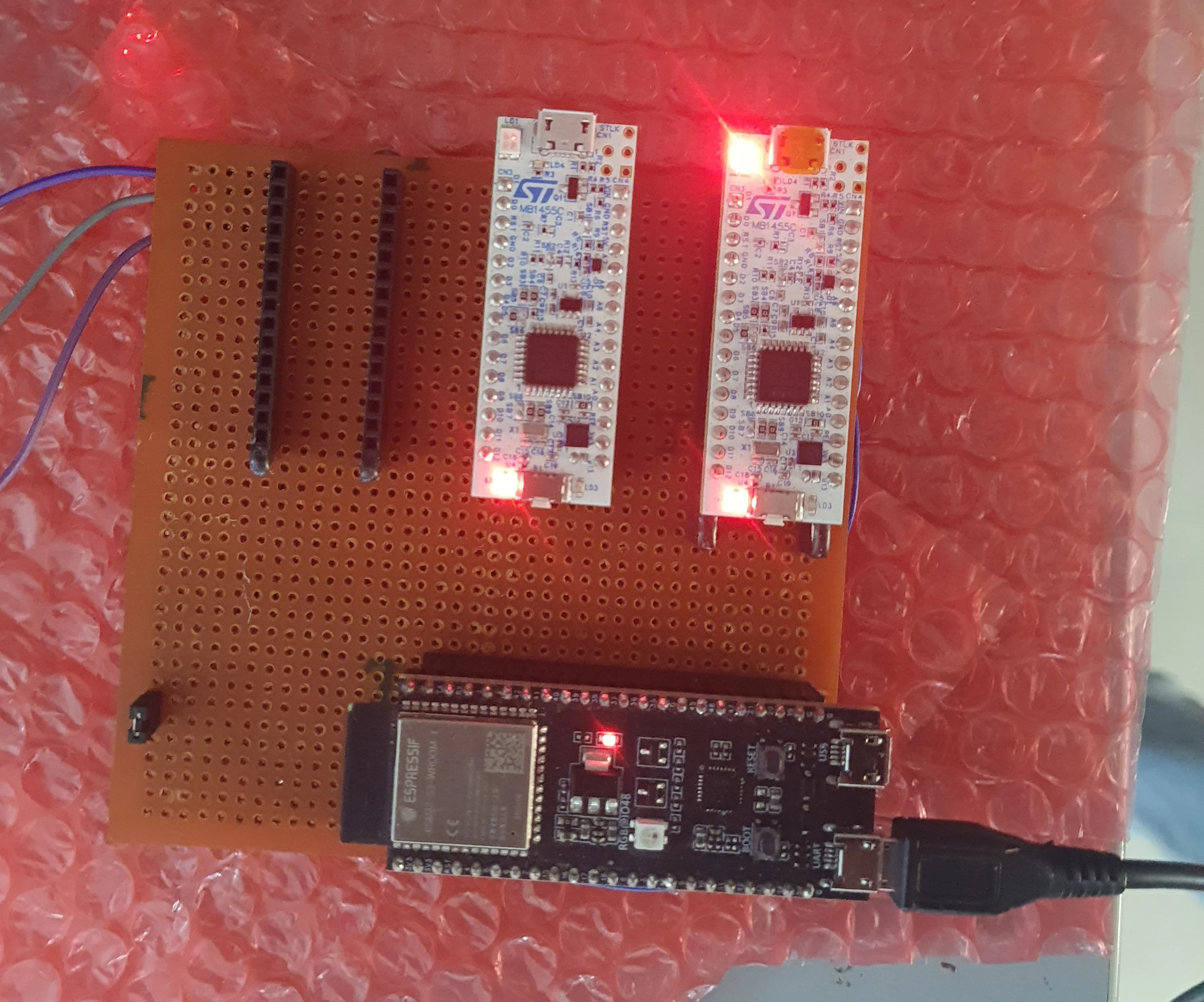

Let me explain further more, about integration of hardware.
As you can see in image we have selected ESP32-S3 devkit as master who control STM32G0 dev kit as slave,
1. Here i have soldered all 3 board on general purpose PCB, with PB6 pin as SCL and PB7 pin as SDA of STM32G0
2. Ground common of all the boards with +5V supply given on VIN pin of STM32G0 from ESP32-S3
3. And inserting the STM32G0 board in female socket one by one, while ESP32-S3 is already plugged in the BUS.
4. Here STM32G0's supply and i2c pins are connecting with BUS at same time.
4. Connected logic analyzer on SDA and SCL Pin
5. External pull-up is 4.7k on master side
6. After powering on the master 1st we inserting 1 slave and commissioning with master by changing its default address 0x01 to 0x60.
7. After successful commissioning we test the set of command which STM32G0 need to do as master using i2c.

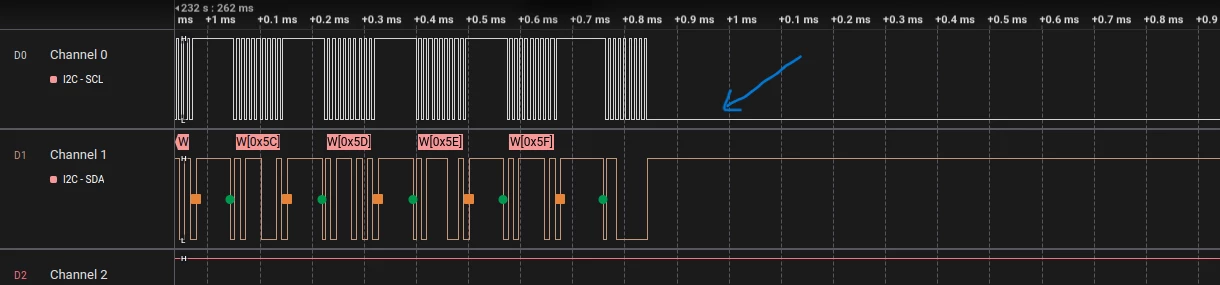

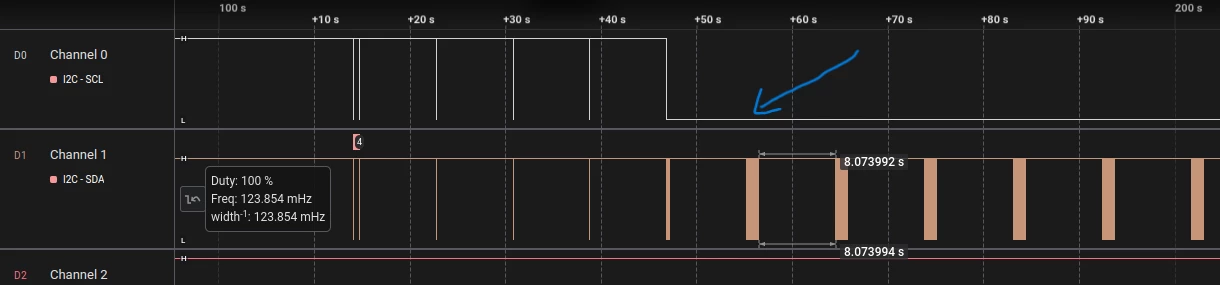

As you can see in logic screenshot one of slave is pulling low the i2c clock line while I inserting 2nd slave.
To free-up i2c buss we are sending stop signal from master but it does not accept as clock is pulled low.
When I reset one of slave the clock line getting back to original state, and we can further commission 2nd slave.
This is the configuration which we have used, better known as plug and play (hot swap) concept.
The strange thing we have noticed that if we do not disconnect i2c pins from master and keep it connected while only plug or remove USB in to STM32G0, this problem never accrued.
I am assuming that on board STLINK (STM32F) debugger which is present on the board might resting the board automatically whenever required. (not sure)
Is it possible ?

Mar 7, 2025 1:02 PM UTC
Hi TDK,
As you suggested, I put the STM32G0 board in debugging mode to check where it is getting stuck. However, I found something strange while in debugging mode, the issue does not occur at all.
But when I disable debugging mode and test with the above hardware configuration, the issue sometimes occurs, but not always. It seems to be a worst-case scenario, meaning the bus does not get stuck every time, but it happens intermittently.
Any thoughts on why this might be happening?
Regards.
Mar 7, 2025 3:10 PM UTC
Okay, so you're doing an I2C transaction every 0.2ms, or at about 5000 Hz.
As a side note: It looks like the master doesn't respect the clock stretching, as it's still toggling SDA even though it's not allowed per the I2C spec.
The underlying cause is almost certainly a bug in the slave I2C code where the address match isn't handled appropriately. It would make the most sense to try and figure out where and why that's occurring and fix it.
As a band aid, you could disable stretching and see if it works. Probably that will just produce errors.
You can attach a debugger to a chip that is already running without resetting it. I would do that to see where the code is stuck and why. Examining the state of the i2c handle would be helpful here.
