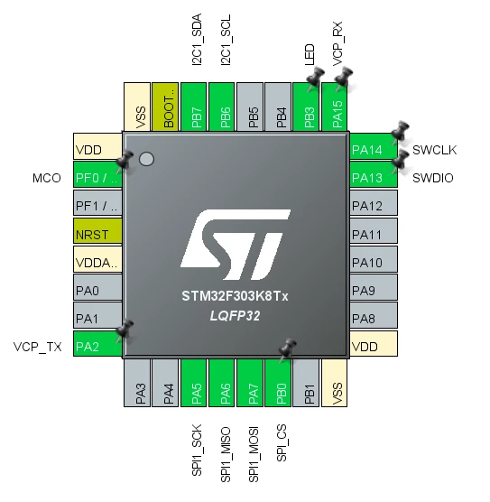

My code including EITHER I2C or SPI works successfully on STM32F303K8T6 Nucleo Board. However, with my code including BOTH I2C and SPI , Only SPI functions work correctly ,but I2Cs don't.
Using a ocsiloscope, It was found that voltage levels of I2C pins don't fluctuate at all when SPI initialization code exists. Is it impossible to use I2C and SPI function at the same time?

Are you using both SPI and I2C on same pins?
CubeMX doesn't support dynamic HW reconfiguration. It has to be done by coding.
Mmats.503
Mmats.503Author
October 26, 2019
No, I2C and SPI are assigned to different pins, but there seems to be something wrong with initialization.

Probably not your issue, but 2 things:
  • You call MC_I2C1_Init() twice - shouldn't hurt but definitely not needed
  • Your HAL_I2C_Master_Transmit() isn't going to send what you THINK/WANT it to send. You assign 0x3F to a byte variable and then pass that variable as a POINTER to the data to send. So it will try to send whatever byte is at address 0x0000003f, not the value 0x3f. You need a '&' before the variable name.
You say the code doesn't work when the SPI init code "exists". Does "exist" mean "present in the code but not called" or does it mean "present in the code and called"? In other words, does that EXACT code send data on the I2C port if you comment out the MX_SPI1_Init() line?
You don't check the HAL_I2C_Master_Transmit() return value, Does it return an error? Use you debugger and step into HAL_I2C_Master_Transmit() and see what is happening.
