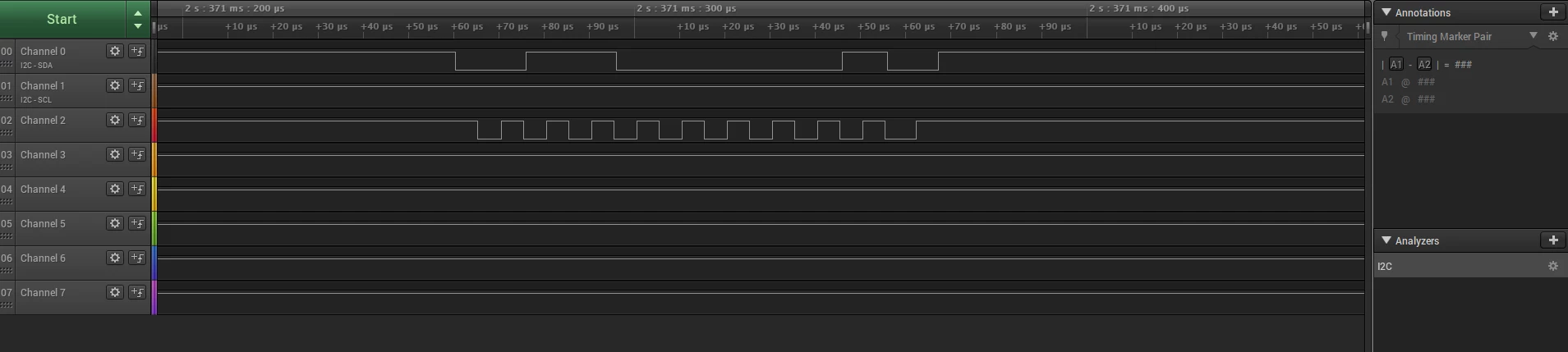

The next picture shows the activity in the I2C bus:

The lack of an ACK indicates nothing on the bus recognizes the address. Triple check the wiring and power for the slave peripheral you expect to respond. Check the address selection bits on devices that support that. Make sure the pins are in OD mode.

PB9 is connected on the DISCOF4 to CS43L22 SDA , although theoretically that should make no harm as long as you keep PB6 at a steady level. There's also already a 4k7 pullup on it, which you should take into account, especially since you have a relatively high serial resistor (I'd consider decreasing it). You may want to use oscilloscope to monitor the I2C lines.

I found the problem. The camera needs an input clock and I was using MCO1, with PLLCLK/4. When I checked the signal I saw that the output looked more like noise than an actual clock. Then, I changed it to output the clock from HSI and it worked. Thank you all for your support.

Could you tell me how you probed your I2C lines?
Using a logic analyzer, apparently. You can use also an oscilloscope.
