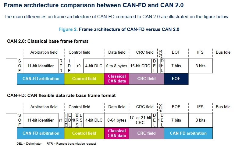

@Community member​ you should take a lok at AN5348
page 2:
CAN-FD features
Main features of the CAN-FD protocol are listed below:
• Compatibility with the CAN protocol: CAN-FD node is able to send/receive CAN messages according to
ISO 11898-1
page5:
And this is why FDCAN supports CAN2.0, the data frames are very similar

This is when FDCAN peripheral is configured in classical mode so no CAN FD frame is transmitted on the bus. I think the original question is: the possibility of the cohabitation of classical CAN & CAN FD frames on the same bus which causes CAN errors from the node using classical CAN frame format according to the doc I mentioned previously in link 2.
