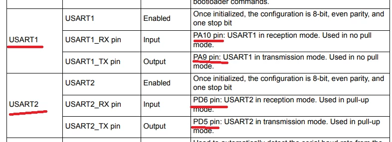

mƎALLEm
Jan 27, 2025 11:54 AM UTC
Hello @mohite25 and welcome to the community,
Need to refer first to the AN2606 / Section 31 STM32F401xD(E) devices:
These are the USARTs and theirs respective pins that you can use with the bootloader for this product:
And you cannot use other pins.
Hope that helps.

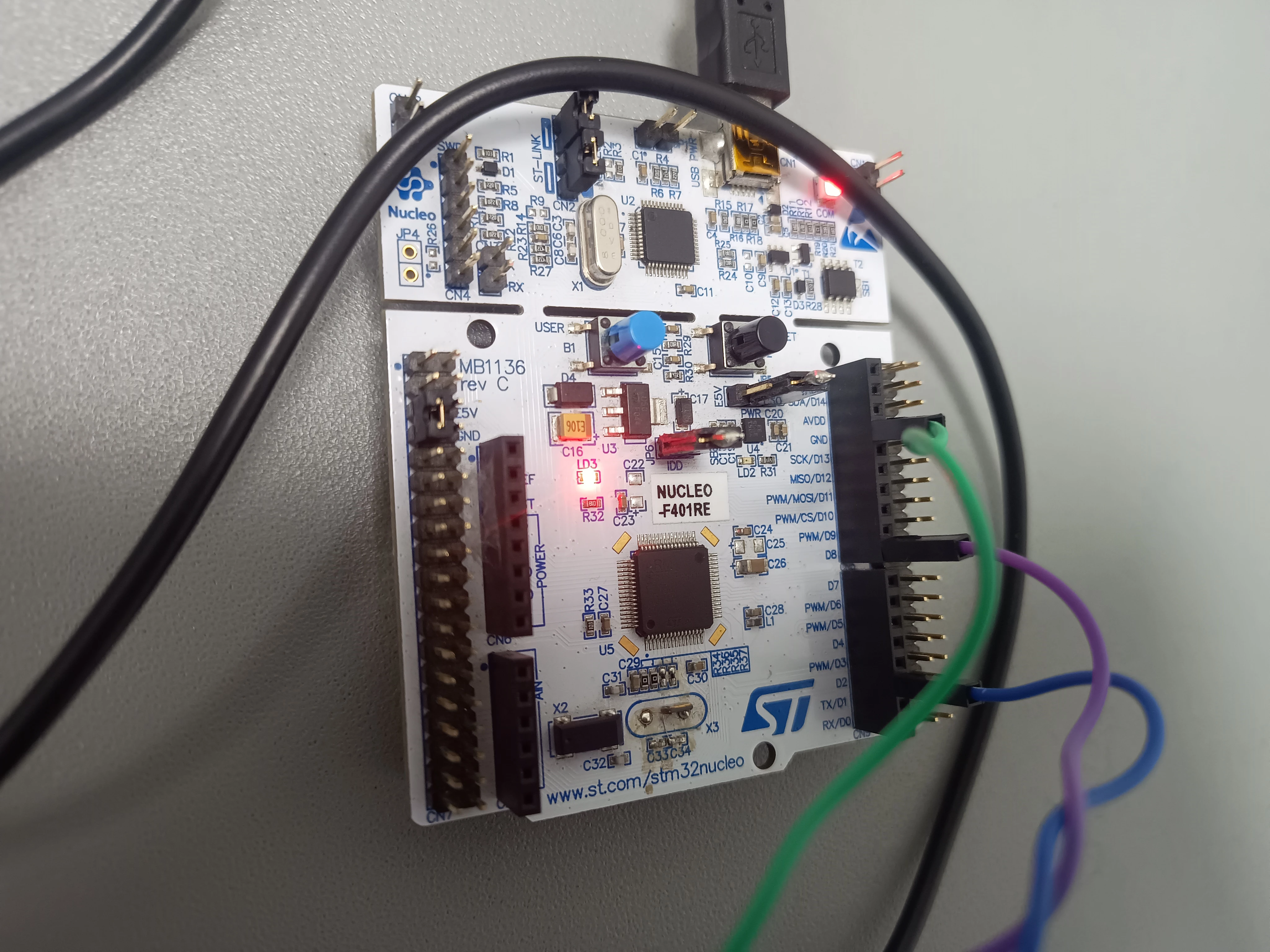

mohite25Author
Jan 27, 2025 12:27 PM UTC
Thank you, @mƎALLEm, for taking the time to answer my question! I really appreciate your help.
Based on the guidance in AN260, I have followed the necessary steps to use USART1 for communication. Here’s what I have done so far:
  • I connected UART1_TX of the STM32 to the RX pin of the FTDI module and UART1_RX to the TX pin of the FTDI module.
  • The VDD pin of the STM32 is connected to the FTDI module to ensure proper power supply.
  • A common ground is established between the Nucleo board and the FTDI module.
  • To enter boot mode, I set the BOOT0 pin to HIGH by connecting it to the E5V pin using a jumper cable.
After making these connections, I connect the FTDI module to my laptop and follow these steps:
  1. Press the reset button on the STM32 board.
  2. Open STM32CubeProgrammer, select UART mode, and choose the correct COM port and baud rate settings.
  3. Click the Connect button.
However, despite following these steps, I am still encountering an error. Could you please help me troubleshoot this issue? Any suggestions would be greatly appreciated!

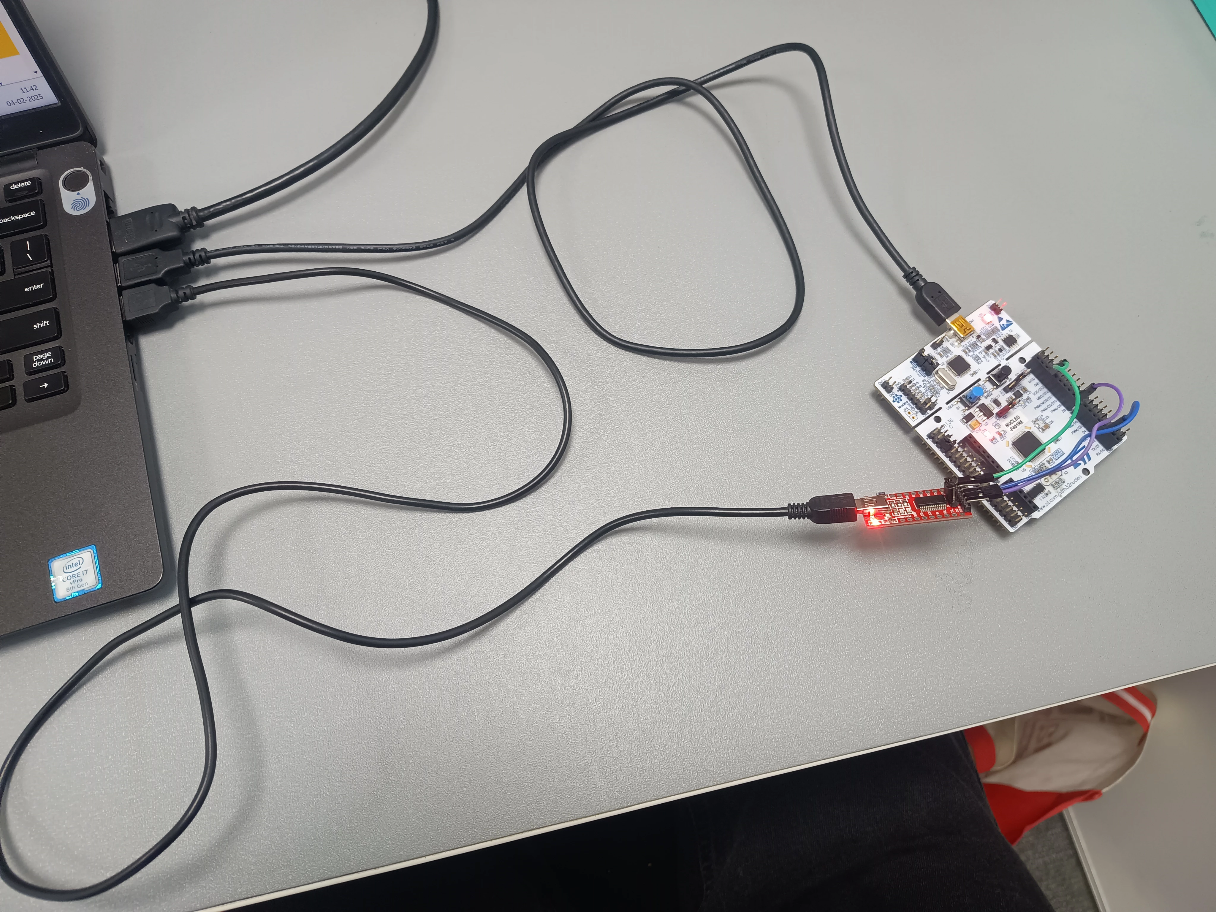

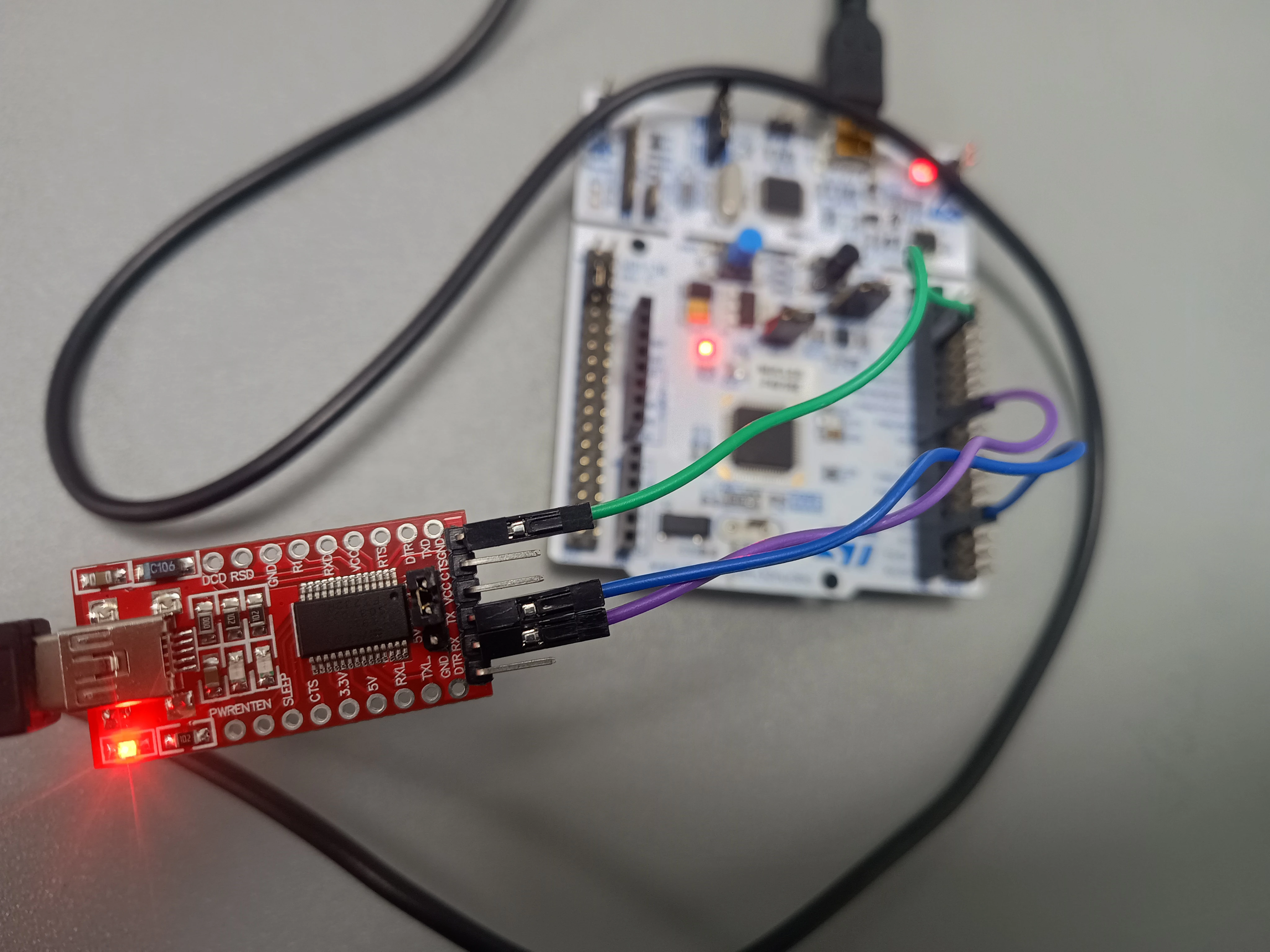

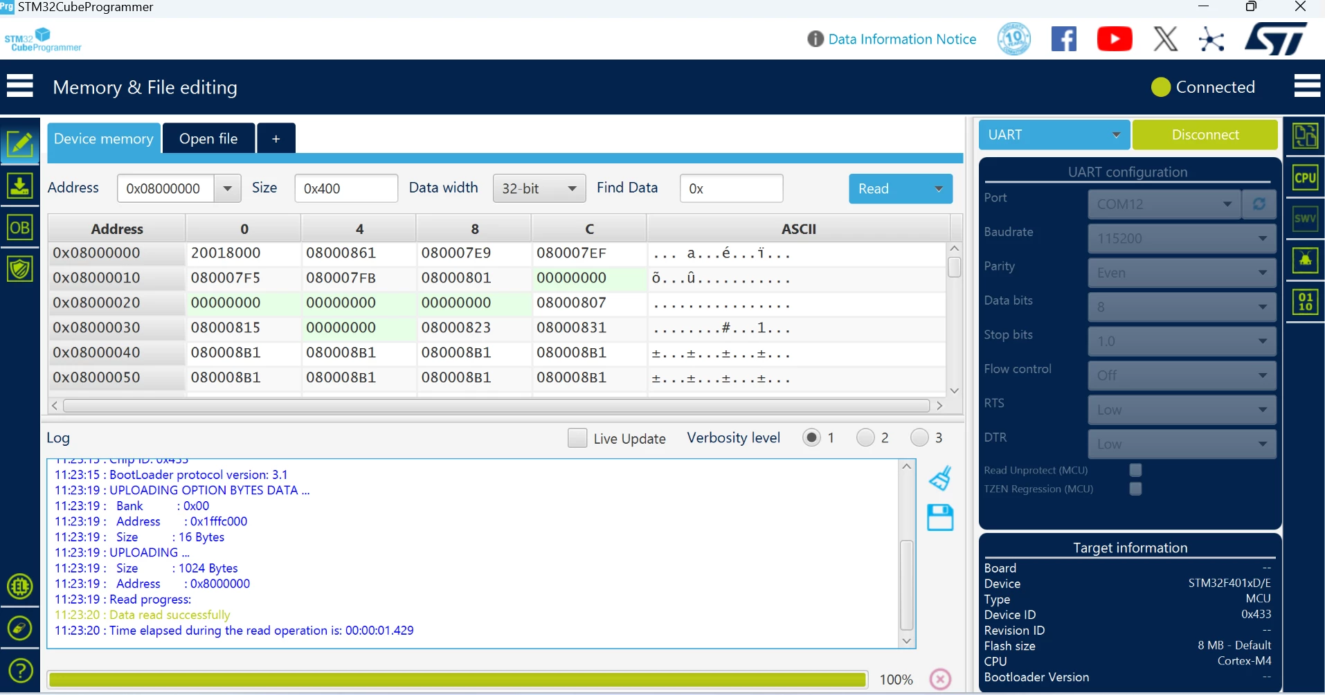

mohite25AuthorBest answer
Feb 4, 2025 6:09 AM UTC
USART1_stmconnectionUSART1_stmconnectionUSART1_FTDIconnectionUSART1_FTDIconnectionpower supplypower supply
Connecting to the UART Bootloader on STM32
After much trial and error, I successfully connected to the UART bootloader on the STM32. Below are the steps I followed:
  1. Connect the USART1_RX pin of the STM32 to the TX pin of the FTDI module.
  2. Connect the USART1_TX pin of the STM32 to the RX pin of the FTDI module.
  3. Ensure a common ground between the STM32 and the FTDI module.
  4. Set the BOOT0 pin high to enter boot mode by connecting it to the VDD pin (do not use any other pin).
  5. Power the STM32 via USB by connecting it to your host, and also power the FTDI module via USB by connecting it to your host.
  6. Open Device Manager and locate the FTDI module’s port (not the STM32 port). Select that port in STM32CubeProgrammer, set the baud rate to 115200, parity to even, and tap on connect. It should connect successfully.
Q1: Why was I experiencing errors and unable to connect my UART Bootloader?
Answer: Initially, I was powering the FTDI module using the STM32 by connecting the VCC of the FTDI to the VCC of the STM32. While this can work if your power output is adequate, to avoid the issues I faced, I recommend powering the FTDI module directly from the host. Ensure you have a common ground between the STM32 and the FTDI module.
I hope this helps the community!  and special thanks to the @Andrew Neil and @mƎALLEm
