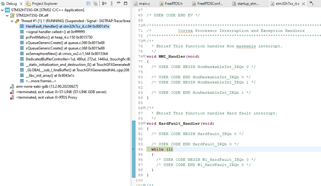

Error: Program gets HardFault Error even before going into main() function.
I think because i put a breakpoint in first line of main() function it is not reaching and i cannot 'reset` the debug using the reverse curved arrow.
What error is shown:

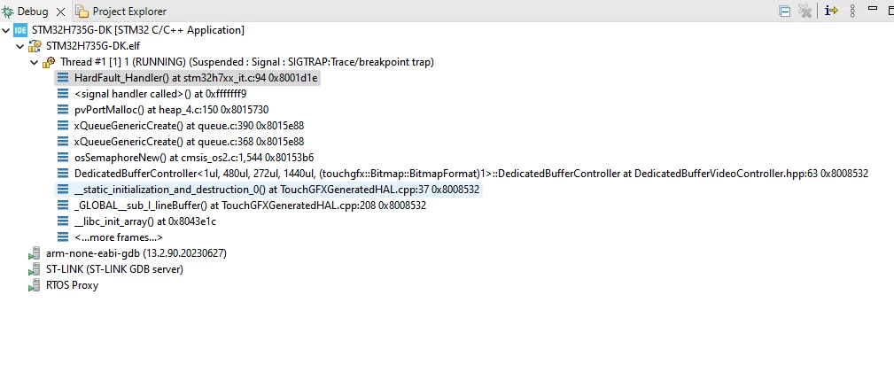

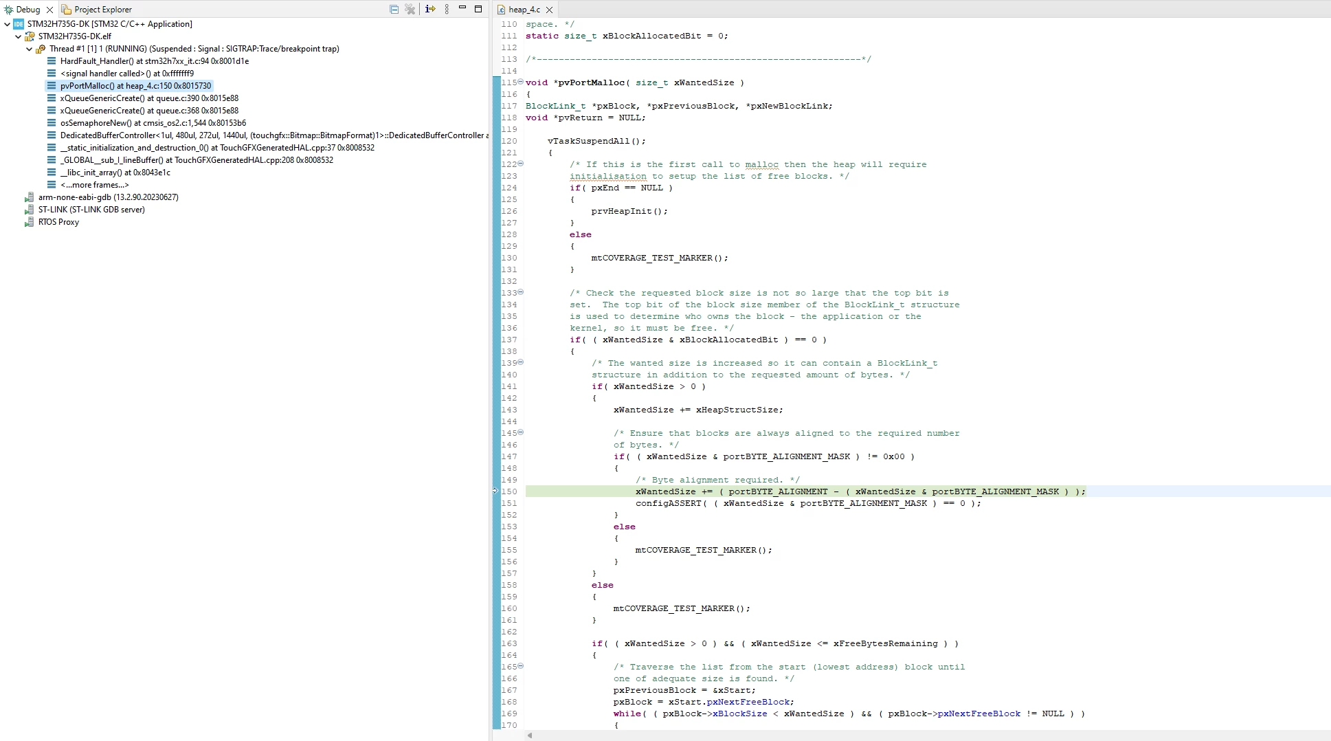

vishnu_illikkal_2-1719987844486.pngheap_4.c having the problem
Observation/Guess : FreeRTOS functions are calling before the init of the External RAM or even before the program is fully start.

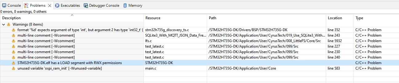

Some RWX permission warning also hapening i don't know what that is
If anyone knows this problem please replay.

@vishnu_illikkal The 2nd attempt was a good try... but it looks from the stack trace like C++ got you ))
There are some static TouchGFX things that initialize before main() and create FreeRTOS objects - which allocate from your new pool in hyperram.  But MX_OCTOSPI2_Init likely is called in your main() - which has not been run yet.
Now - if this guesswork is correct - you can easily fix it.
