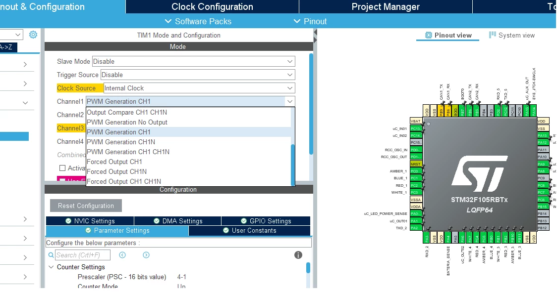

Timer1 is what youre looking for.
Think of every pwm phase you need as a timmer1´s channel (1,2,3,4)
Every timer channel in PWM generation mode has the option to produce a single pwm signal with adjustable duty CH1 or a pair of pwm signals CH1 and CH1N for example where CH1N is the inverse of CH1 but respecting the programmed switching deadtimes.
sadly the CH4 doesnt have the option of producing also CH4N....

I think the channels won't give the required phase shift(all though duty can be independently controlled) between each other say I will use 3 channels itself , the phase shift between each channel should be 120 degree if its four channels the phase shift should be 90 degree between each channel. but still I will try it out and get back.

I see.. the solution i gave you gives you perfectly in sync pwms, so no bueno for you.
