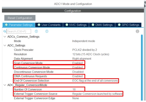

I want to Configure 16 adc in DMA mode (Stm32f410RB microcontoller)
  • September 23, 2021
  • 1 reply
  • 779 views
i use nucleo - f410RB board , i want to configure 16 adc channel continuous conversion and continuous scan mode, we use cube mx for adc dma code generation , but generated code not working , so please help me how to configure adc in dma mode so adc is working in nucleo-f410rb board so
please help me
thanks
1 reply
September 24, 2021
Dear @Lkhod.1​ ,
Using CubeMX you will configure ADC & DMA together in order to use SCAN mode on 16 ADC's channels.
First of all, check you have enabled each channel.
Then, go to Parameters Settings tab and check that your configuration is the same as below:

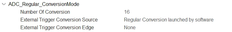

0693W00000FAMJjQAP.pngThen, after it should appear 16 Rank sections, for each of them, select the input channel and the Sampling Time. If you decide to not choose a specific Sampling Time, 3 Cycles option is selected.

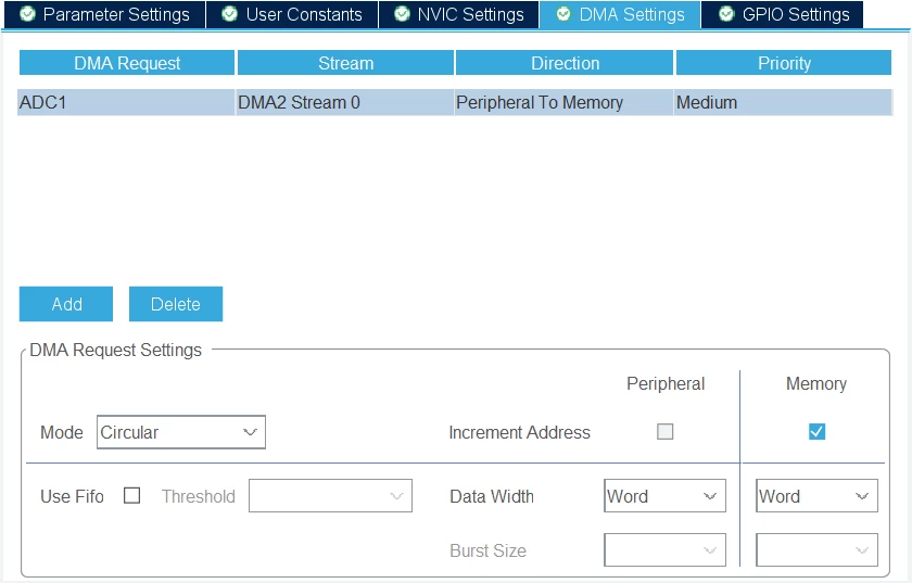

Go on DMA Settings tab (always in ADC1 parameters) and click on add button. As you want to convert in continuous mode, DMA will work as a circular buffer so select Mode Circular. The Addresses of your memory need to be increment automatically to fill your array. For that enables Memory Increment Address by checking the box and your data width will be a Word (or half-word 16-bit if you want).
Now your ADC and DMA are correctly configured. Now it's required to add some lines of code to start ADC and DMA.
