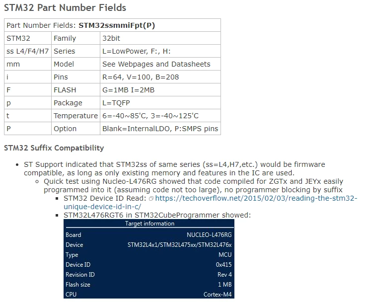

    1. Install STM32CubeMX (Software to configure an STM32 MCU, including selection, feature enable, and pinout)
    2. Select "Access MCU Selector"
    3. Set all the features you need
    4. Select a chip from presented ICs
    5. Compatibility: ICs with these same numbers should be pinout & firmware compatible compatible (Meaning you switch chips in these covid days of difficult sourcing), Though always verify the new chip can actually do your pinout in MX first, as some chips will of course have differences in Memory Size and a few extra features. From our internal wiki:
