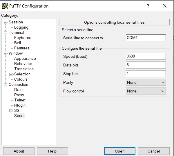

I have been struggling with the connection with RS232 between the sub-D port on my STM32F769I-EVAL and my Computer for sometime . I did follow the tutorial insturctions (https://www.youtube.com/watch?v=tMS5IOfZXyo) step by step but I don't get any signal back from the sub-D port (USART1 CN7). I try to read the signal with the Putty-Application and I took the same port configuration as in my program (see the picture below).0693W000004J4FiQAK.png
Is there an error in the code (see in attachment) or did I a mistake in connection the board to my computer? (To connect I took a sub-D cable.)

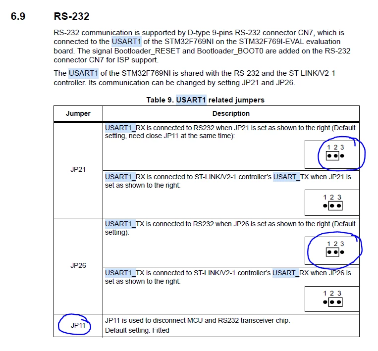

I checked the pins (PA9 and PA10) and jumpers. The jumpers are positioned like in the picture in the appendix and JP11 is closed (see picture jumper_configuration).0693W000004J7aKQAS.png Further I have opened SB68, R265 and R115 (see picture PA9 and PA10).0693W000004J7Z7QAK.png0693W000004J7ZCQA0.png

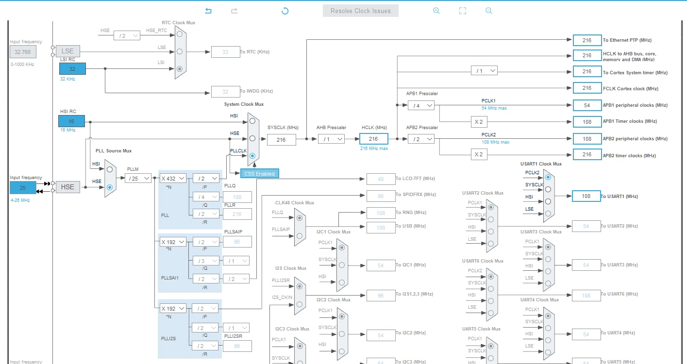

I used the hint with the clock and set the HSE clock to 25 MHz (see picture clock_configuration). But with the clock setting I am still not quite sure if I did it right.0693W000004J7ZlQAK.png

I attached also the .ioc-file. It's maybe easier to read than the picture with the clock configuration.
