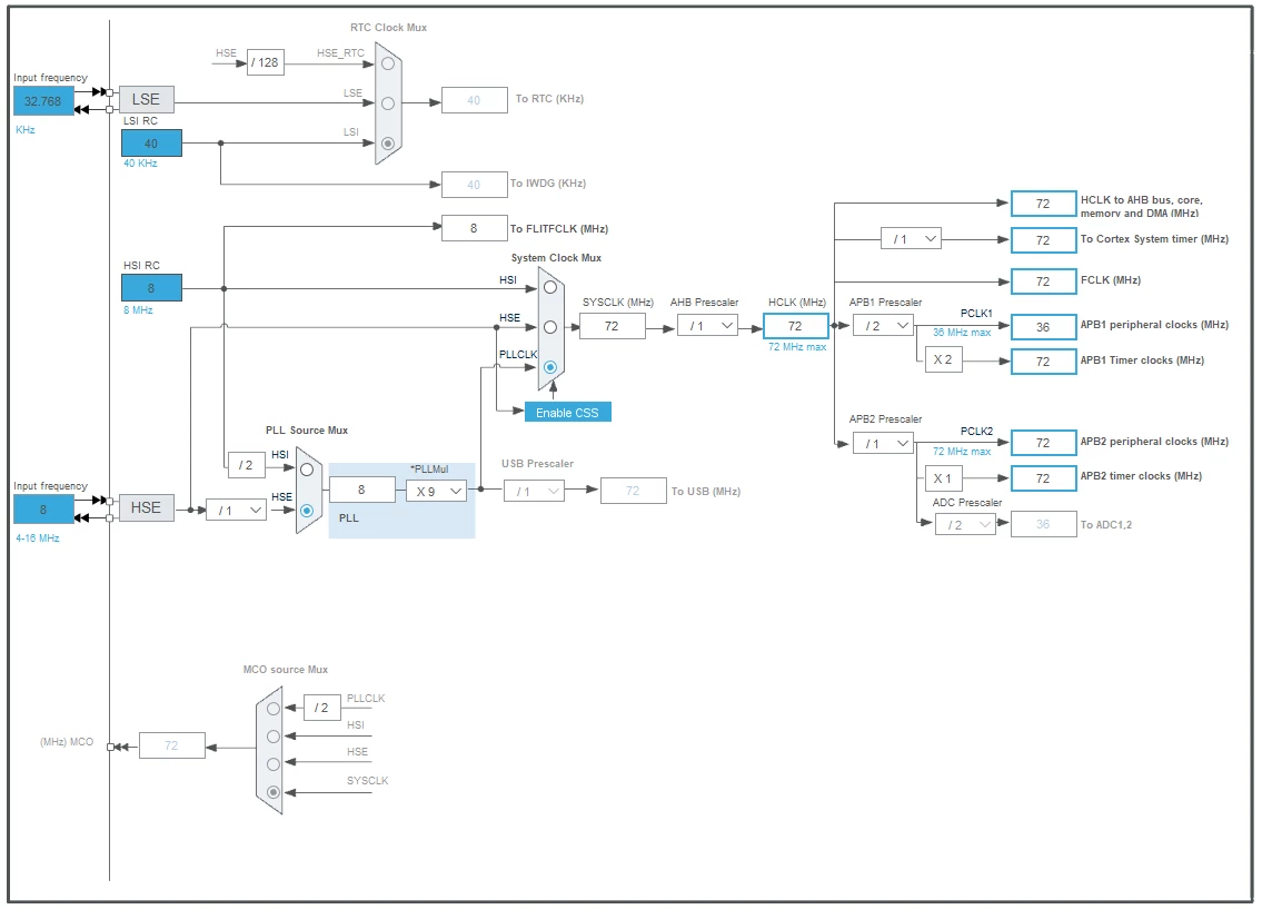

I set the MCU STM32F103C8 to 72 MHz (8 MHz external oscillator). However, the function does not give exactly 1 ms of time, but a value approximately 4 times larger. Any suggestion?
0693W00000Bc4cEQAR.pngvoid delay_ms ( unsigned int i ){
  unsigned int temp;
  SysTick-> LOAD = 9000 * i; // if subtle, the SysTick-> LOAd = 9 * i;
  SysTick->CTRL = 0x01;
  SysTick->VAL = 0;
  do{
 temp = SysTick-> CTRL; // read the current countdown value
  }while ( ( temp & 0x01 ) && ( !( temp & ( 1 << 16 ) ) ) );
 SysTick-> CTRL = 0x00; // Close counter
 SysTick-> VAL = 0; // counter is cleared

Try doing this with a simple free-running TIM clocking at 1 MHz, 16-bit maximal mode
SysTick counts DOWN
Review what actual code is executing with the RCC/PLL settings.
Output the internal clock via MCO (PA8) and scope that.
Tesla DeLorean
Guru
June 26, 2021
For sub-microsecond granularity look at DWT CYCCNT, 32-bit up-count at core frequency
SysTick can clock at SYSCLK(HCLK,) or the SYSCLK DIV8, 24-bit down-count
