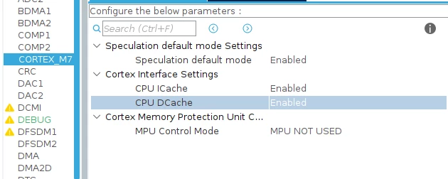

I recently ported my STM32F413 (run at 100Mhz) application to a STM32H7A3 (run at 280-Mhz). But my DSP routine does not run 2.8x faster. Anyone has any idea how this happened?
I measured the time took to run a length 127 Multiply–accumulate routine by togging a GPIO pin before and after the arm_dot_prod_q15() routine. And then I can measure pulse width by a scope. It was 7us on the STM32F413 and 6us on the STM32H7A3.

7 -> 6 us --- not what we expect. just very short test time...to make it shure, that not pin switching or something else comes in :
can you make a loop and run your test 1000x ? then see on scope 7 -> ? ms .
and cache setting - i would try this (+ try : use normal memory )

Check cache setting!

What cache? I put the critical code in ITCM and data in DTCM. The difference is small. By the manual, the core takes more than 1 cycle/data, so I am not surprise that DTCM does not speed up the routine.

Thanks a lot. It works. It is reduced to less than 2us. The speed up is more than 2.8x.

For a performance measurement measure at least tens or hundreds of thousands iterations and disable the interrupts during that measurement.
The Cortex-M7 in STM32H7A3 should be about 5 times faster than the Cortex-M4 in STM32F413 , not 2,8 times.

Yes, indeed. It is more than 2.8x, and close to 5x.
