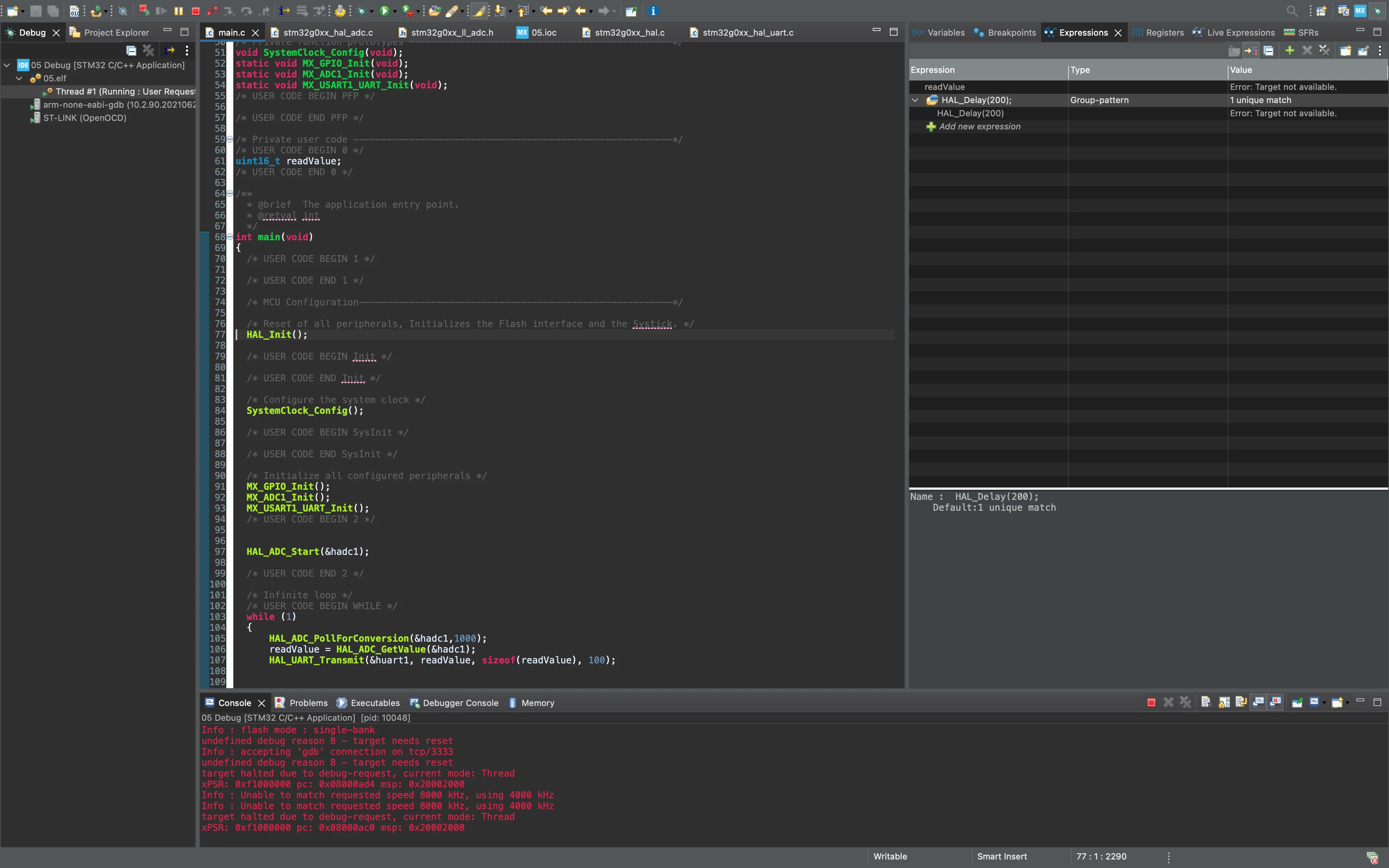

I need to transmit my getting data from adc. But as I am very bigger I do not know how to do it, I would be happy if you take a look at my code in attachment and give me idea. Thanks

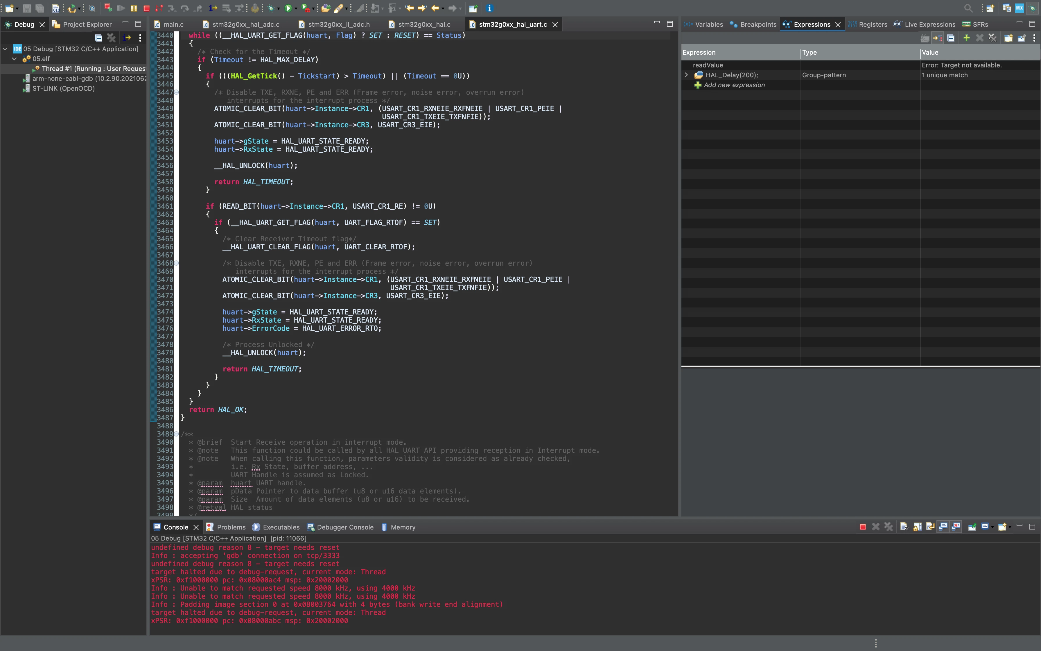

MFara.4
MFara.4Author
December 9, 2022
Thanks for the reply :folded_hands:
but again the problem is not solved!

 HAL_ADC_Start(&hadc1);
 /* USER CODE END 2 */
 /* Infinite loop */
 /* USER CODE BEGIN WHILE */
 while (1)
 HAL_ADC_PollForConversion(&hadc1,1000);
 readValue = HAL_ADC_GetValue(&hadc1);
 HAL_UART_Transmit(&huart1, (uint8_t *)&readValue, sizeof(readValue), 100);
"The Problem" is ill defined.
No idea what board or chip you are using.
No idea how and to what the UART is configured and connected.
No idea what terminal app you have connected, what you are seeing, or what you expect to see.
