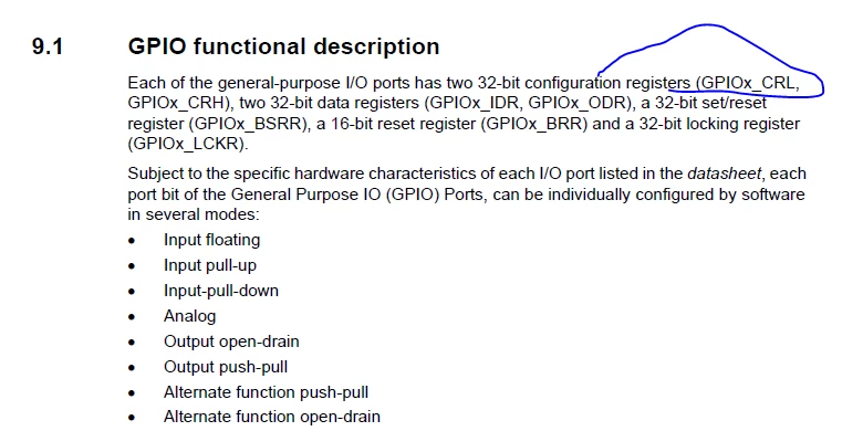

Hi, This is sureshkumar, I bought one STM32 popular udemy course, on that course have one video that trainer shows some registers to set the pin directions. but my data sheet is showing different name of the register. on that video showing MODE register (0-31), But mine is showing like this
"Each of the general-purpose I/O ports has two 32-bit configuration registers (GPIOx_CRL,GPIOx_CRH)" like 2 words 0-15 and 16-31
And Finally What is the meaning of Push Pull output ?.
Find the attachment CRL,CRH instead of MODE Register.
//PA5
//APB2
//RCC_APB2ENR For Port A to access = 0x00000004
//GPIOx_CRL and GPIOx_CRH
//GPIOx_ODR
#include "stm32f10x.h" // Device header
void delay(int para);
int main(void){
RCC->APB2ENR |= 0x100;
RCC->APB2RSTR |= 0x1;
GPIOA->CRH |= 0x30000;
GPIOA->CRL |= 0x00000;
while(1){
GPIOA->ODR |= 0x10;
delay(100);
GPIOA->ODR |= 0x00;
delay(100);
void delay(int para){
for(; para>0; para--){
for(int i=10000; i<10000; i--);
What is the wrong in this program ?. this just try to blink the LED PA5

No need to "like" your own post.
There are many STM32 families, the F1 being the oldest.
Push-Pull the output uses both P and N transistors to alternately connect VCC or GND to the output. See diagram "Basic structure of a standard I/O port bit" in RM
Register level code requires a mastery of the Reference Manual (RM), and the use of a debugger to inspect what you've done.
It's a mess
Looks like you're not enabling the right GPIO clock (G), and holding another peripheral in reset (AFIO).
Delay loops should use volatile for the iterating variable so as not to have it optimized away.
Step the code, inspect the registers.
Or'ing something with ZERO has no helpful effect. Toggle pin with GPIOA->ODR ^= 0x20; // PA5 Or clear GPIOA->ODR &= ~0x20; // tilde (forum looks like minus, should copy ok)
PA5 is (1 << 5) not (1 << 4)
CR I think you are configuring PA4
October 1, 2019
In addition to what Clive points out, this loop will run for exactly 0 iterations since the starting value doesn't meet the condition.
You probably meant this:
for (volatile int i=0; i<10000; i++);
