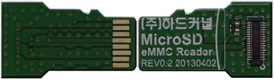

I need to interface a mass storage device (of size 8 GB or more) to STM32F769I. SD/microSD/USB disk do not suit my requirements. Hence, I am looking at eMMC/NAND Flash. Is it possible to interface eMMC to STM32F769I? If Yes, How?

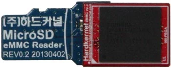

eMMC memory connects like an SD card would, the primary communications pins are the same. The STM32F769I-EVAL board supports two microSD sockets.
One can evaluate eMMC using ODROID adapters and modules. There is a microSD form-factor adapter.
https://www.hardkernel.com/main/products/prdt_info.php?g_code=G135415955758
Driver code needs to be modified to recognize and use eMMC based memory. I can consult on that if you need assistance.

I've worked with 16GB, 32GB and 128GB successfully, and worked with a couple of people to get 8GB Sandisk eMMC functioning.
The 4 and 8GB parts should work materially the same, but tend to be at the bottom end of the scale. As costs drop I suspect some of the smaller devices will decline in availability. The form factor permits a transition to next available sizes.

That's great to know. The ODROID module you mentioned is cool. I shall use this to test my program on the kit. But, finally I would like to make a PCB with STM32F769I interfaced to eMMC. Can I get any reference design for this purpose?
