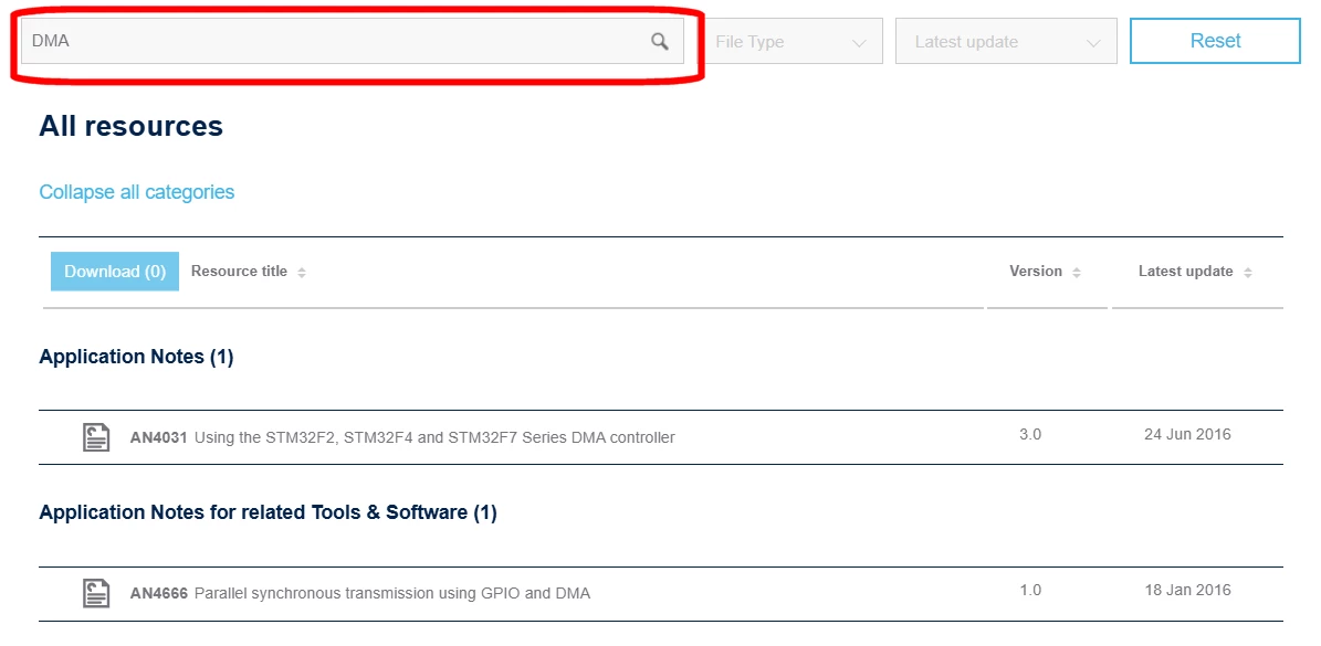

@macam1 The Reference Manual, along with all other support materials, can always be found via the Product Page for the particular microcontroller.
You haven't said what microcontroller you're using but, by way of example, here's the Product Page for the STM32F407VE:
https://www.st.com/en/microcontrollers-microprocessors/stm32f407ve.html
See the 'Documentation' tab for datasheet, Reference Manual, Application Notes, etc:
https://www.st.com/en/microcontrollers-microprocessors/stm32f407ve.html#documentation
There is a search facility:
