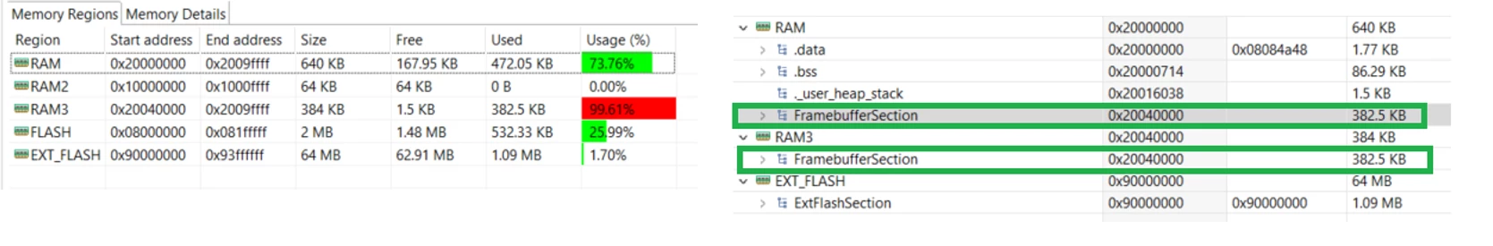

I'm using STML4R9ZI MCU and TouchFGX framework to implement my UI application. I have used 4' display, therefore required framebuffer size is 480 * 272. So question is how we can use the RAM3 section to hold framebuffer?
This MCU is having 3 RAM sections:
RAM : 640KB,
RAM2: 64KB,
RAM3: 384KB
I have modified my linker script(attached here) but don't know why the framebuffer is stored in RAM as well RAM3 section as per below snap?
Linker script: STM32L4R9AIIX_FLASH.zip

    Simple because RAM3 overlaps RAM.

    Thank you @MM..1​ for taking my attention towards the memory map of this MCU.
    This MCU has a total of 640KB(RAM1:192, RAM2: 64, and RAM:384).
