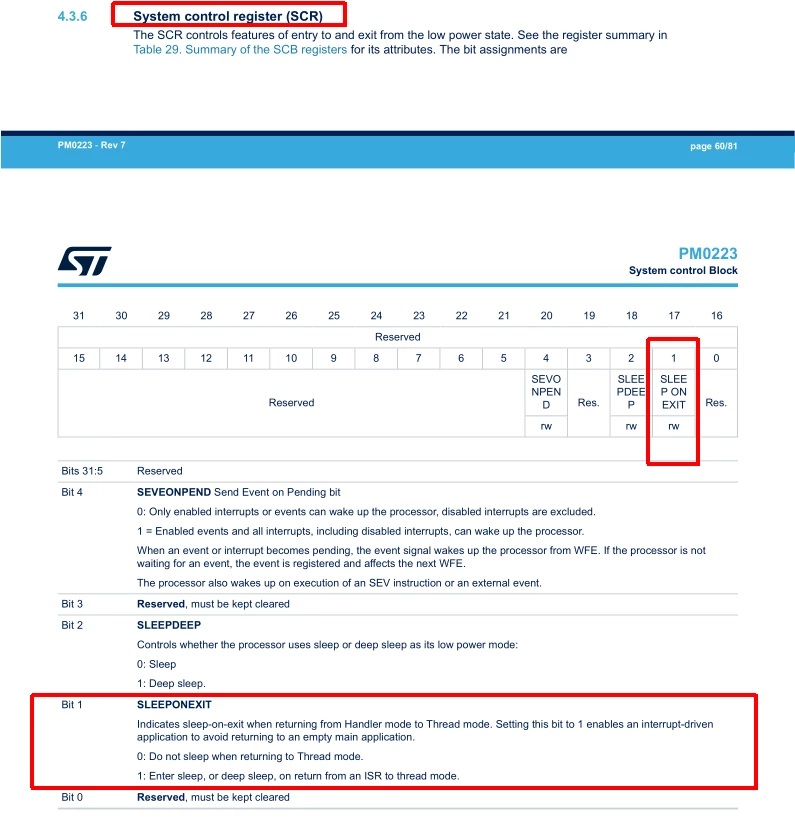

I'm using an STM32G0. The CPU is in STOP MODE and is woken up by RTC. There are also ISR generated by the GPIOS. Is there any way for ISRs to return the processor to STOPMODE on their exit? BR Gilberto
