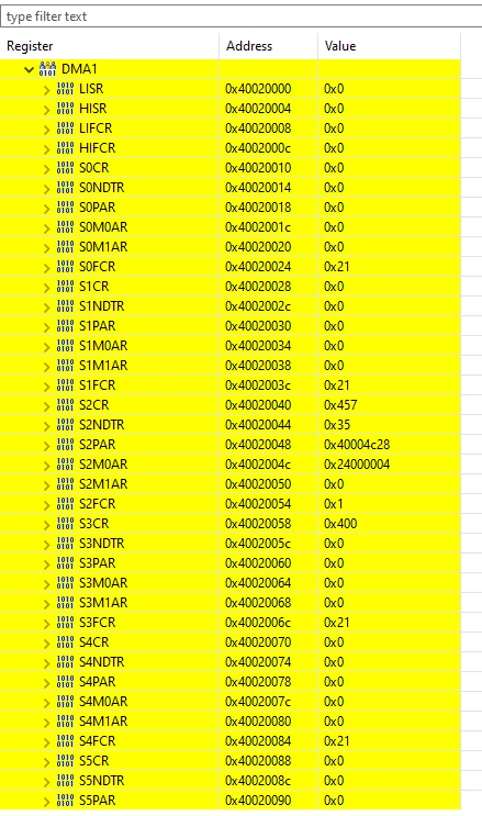

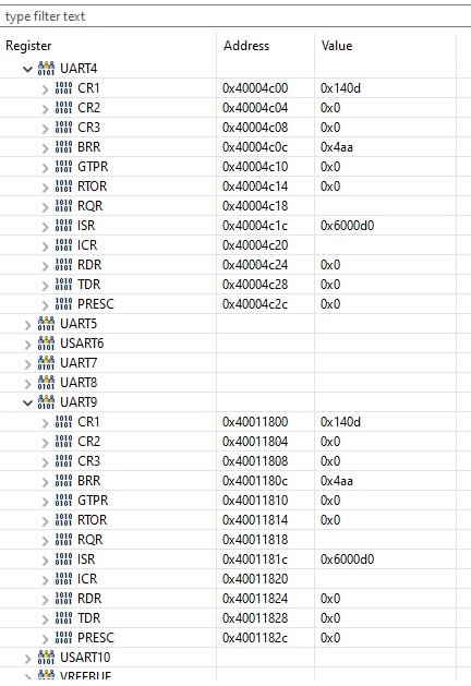

ESega.1
ESega.1Author
December 22, 2021
Do these help?
December 22, 2021
Those values aren't consistent with the code you presented. The DMA1_S0M0AR register (among others) is 0 but clearly it's being set in the code:
>  LL_DMA_SetMemoryAddress(DMA1, LL_DMA_STREAM_0,(uint32_t)aUart9TxBuffer);
If the clock wasn't enabled, stream 2 values would be zero. Step through the code and verify these values are getting set on the appropriate line.
I could be missing something but don't think I am.
waclawek.jan
December 22, 2021
That does not mean the clock is enabled while writing into Stream0 and Stream1.
December 23, 2021
If the registers are shown at the end of the initialization code shown, it does. Which is what I requested. But it's entirely possible that's not where they were taken.
DMAT also isn't set on either UART4 or UART9, so it's unclear how UART4 is "working".
