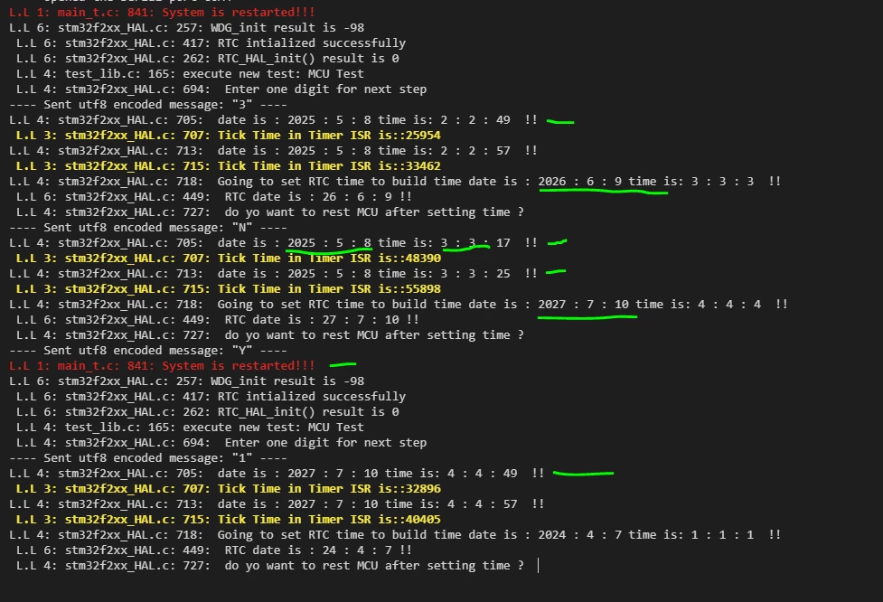

I have to restart MCU to set RTC date in STM32F205ZG. I wrote a Set date and set time function for RTC. while Set time function updates the RTC time properly, set date function does not update the RTC date until I reset the MCU!

when I call the RTC_set_date function, it does not update the RTC date, while set time function works properly. I use the following line of the code to restart the MCU
    if ((cmd =='Y') || (cmd=='y'))
      SCB->AIRCR = 0x05FA0004;
in the attachment you can see the function output in different steps.

How do you read the time/date?
MYahy.1
MYahy.1Author
April 7, 2023
Thanks for the reply,
there is a delay around 2 second, between writing a date and time and reading them back according to the following piece of code.
RTC_set_time(inHour,inMin,inSec);
RTC_set_date(inYear,inMonth,inDay)
delay_100ns(10u*1000u*1000u*10u);
RTC_get_date(&year, &month, &day);
RTC_get_time(&hour, &min, &sec);
runningTimer = get_run_time_ms();
printf( " date is : %d : %d : %d time is: %d : %d : %d  !!\n", year, month, day, hour, min, sec);

at first steps I had done this also, but it did not work.
It is interesting when I monitor the RTC_DR in debug mode the code work. and it modify date as well as time. but as soon as I stop monitoring the register value it does not work!

Well then it's maybe some other mechanism, maybe some which involves problem in RTC_WaitForSynchro().
You may want to avoid using libraries and resort to programming through registers. RTC may be tricky, read the RTC chapter in RM, and here and here and here. The 'F2 family RTC is slightly different from the 'F4 family so there may be some minor but important differentces, and I don't have personal experience with 'F2.

You are right, some minutes a go I solve the issue.
it seems the RTC_WaitforSynchro() does not work properly!!
So I have to run it two times! while it seems the function follows the instructions in the Reference manual.!!!!
So I ma worried, If the issue is related to a potential timing issue during the RTC initialization or synchronization process, you may want to adjust your code accordingly to ensure that the RTC is properly initialized and synchronized with the system clock.
