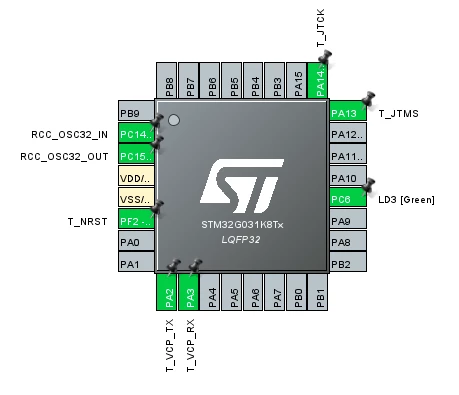

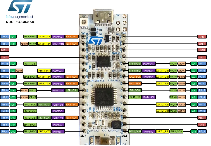

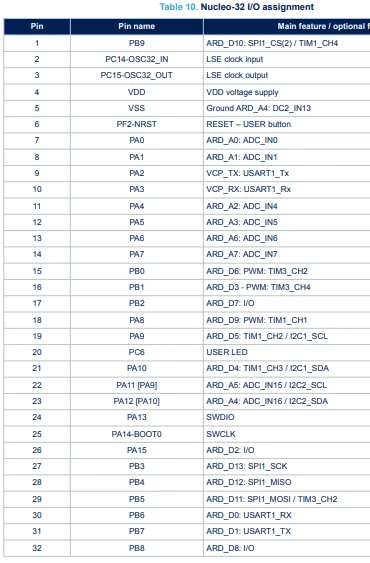

I have NUCLEO-G031K8 development board. I downloaded data sheet. I am not able to undrstand the pin configuration.
_legacyfs_online_stmicro_images_0693W00000bkKxfQAE.png why this mismatch in this or did i get confused? please help me with this. i want to connect user led port to external led

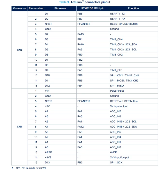

Your pins avaiable on your stm32g0 directly through goldpins are in following tables:

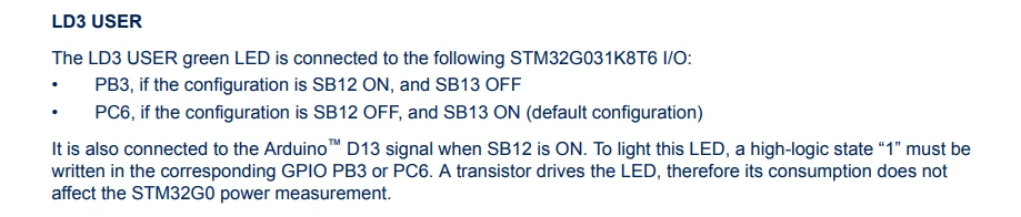

If you want connect user led with external led you must change soldier brigdes:
_legacyfs_online_stmicro_images_0693W00000bkLMYQA2.pngand them connect your external led to PB3
