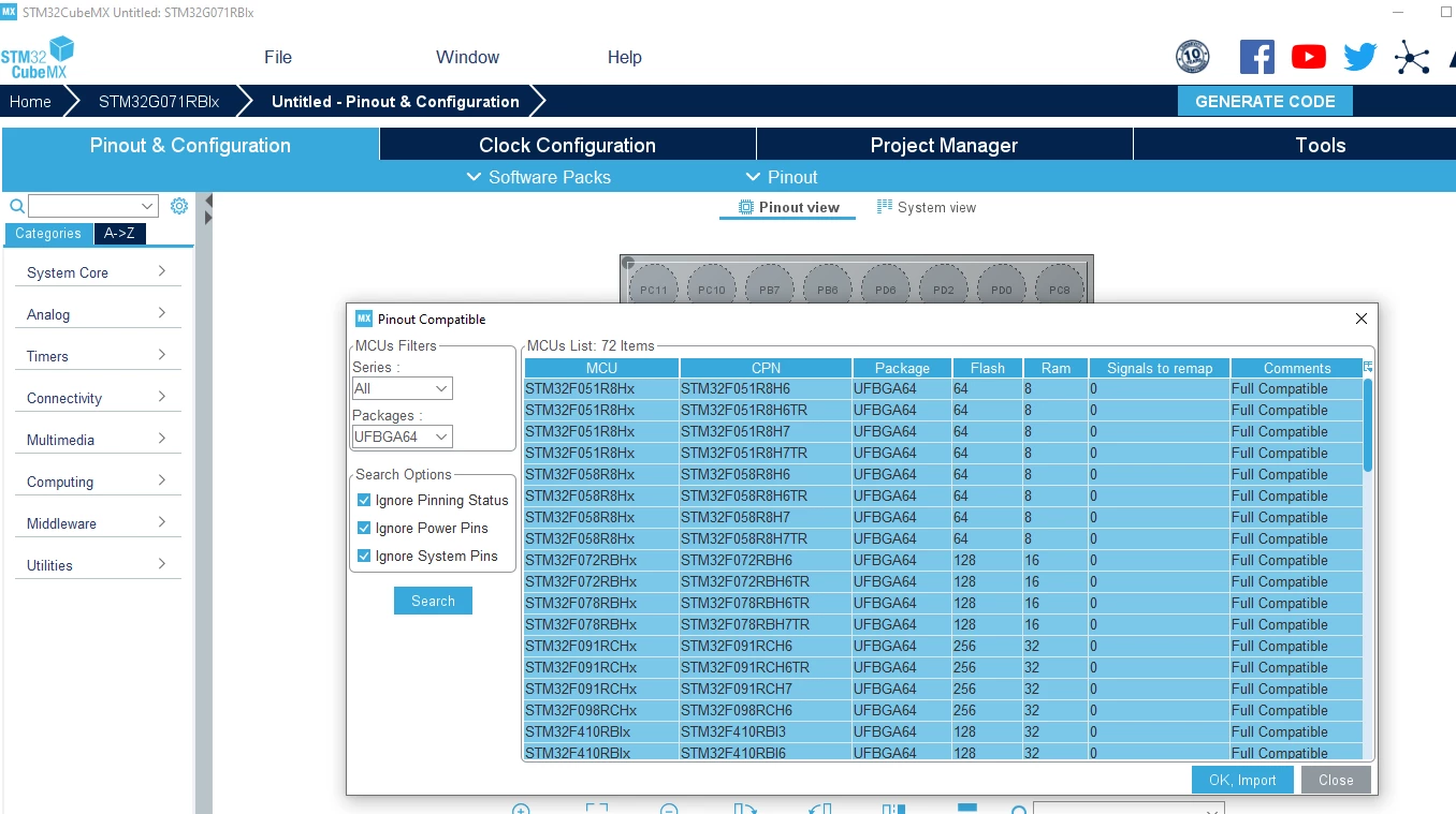

I have battery simulator solution written for STM32G071RB microcontroller and would like to know if i can use boards with STM32F4 microcontroller. I guess it depends on pin layout or similar? Thanks in advance Tomislav
  • February 13, 2023
  • 1 reply
  • 627 views
    1 reply
    Javier1
    Principal
    February 13, 2023

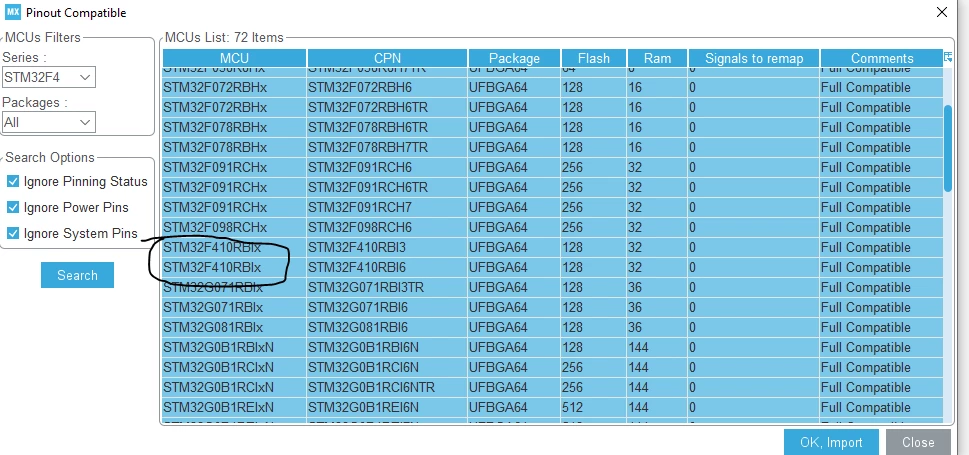

    You guessed right.
    1. download cubeMX,
    2. open a new project with your STM32G071RB(your package digit is missing) mcu, File->New
    3. press Alt+L, enjoy the list of compatible mcus.
    for example: STM32G071RBIx
