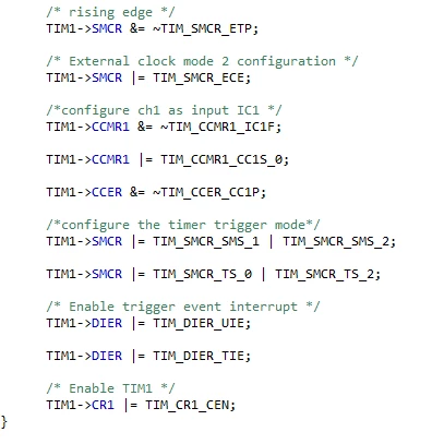

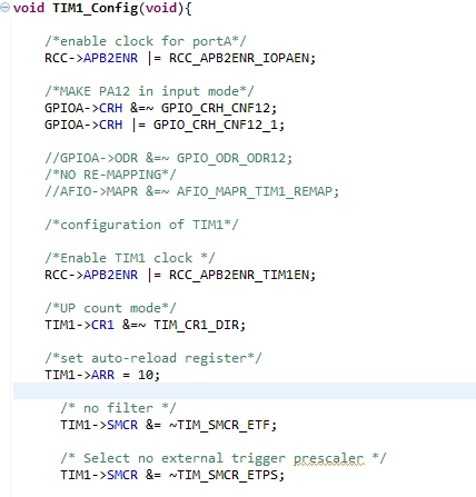

I have a problem with configuration the TIM1-ETR in stm32f1
  • October 14, 2020
  • 0 replies
  • 713 views
