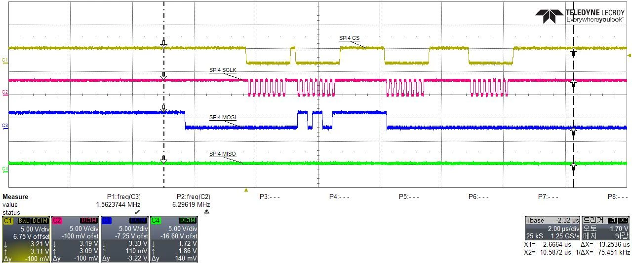

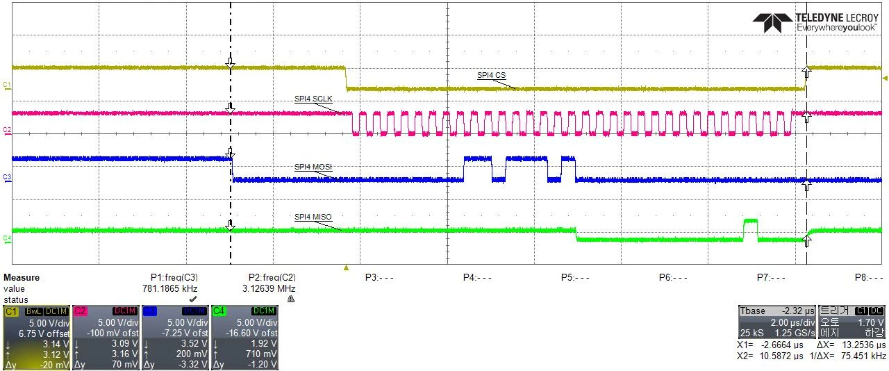

I'm trying to do SPI communication with an ADE1201 chip through an STM32H753VIT6 chip.
The maximum allowed frequency of the ADE1201 is 10MHZ, so I set the SPI to communicate with the MCU at 6.25MHZ.
(The clock for SPI communication is 25MHZ, and I set the PRESCALER value to 4).
However, a strange phenomenon was observed.
I observed through the scope that the SPI CS signal should be 0 continuously, but it turns to 1 in the middle.(See attached photo).
However, if I set the PRESCALER value to 8, the CS signal is continuously output as 0.
What could be the cause? And how can I solve this?
Could this be due to the usage of HAL_SPI_TransmitReceive function?

Hello @KDG ,
As I can see, here some remarks :
  • You declares NSSPMode to SPI_NSS_PULSE_ENABLE. This mode is activated by the SSOM bit in the SPIx_CR2 register. For SSOM = 1, SPI data frames are interleaved with SS non active pulses when MIDI[3:0]>1. That's explaining the behavior of your SPI4 CS line. According to RM0433, we are in a situation quite similar as shown in figure 620.Pierre_P_0-1706785910666.pngCan you change to SPI_NSS_PULSE_DISABLE ? Does that solve your issue ?
  • It's recommended to set MasterKeepIOState to SPI_MASTER_KEEP_IO_STATE_ENABLE to avoid glitches.

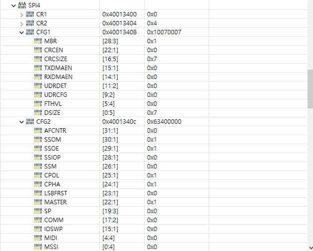

  • These are the values for the registers that you required
    • There are only one master on the bus
I wonder if this would be enough for your remarks.

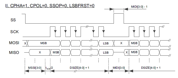

Hello @KDG ,

KDGAuthor
Feb 2, 2024 8:34 AM UTC
Thanks @Pierre_Paris
By your remarks, my problem is solved.
