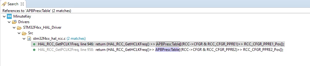

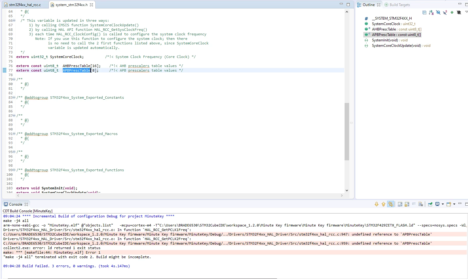

I have a error related to APBPrescTable. It is in the .h file but no table. Have I loaded the IDE incorrectly?

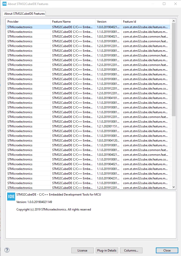

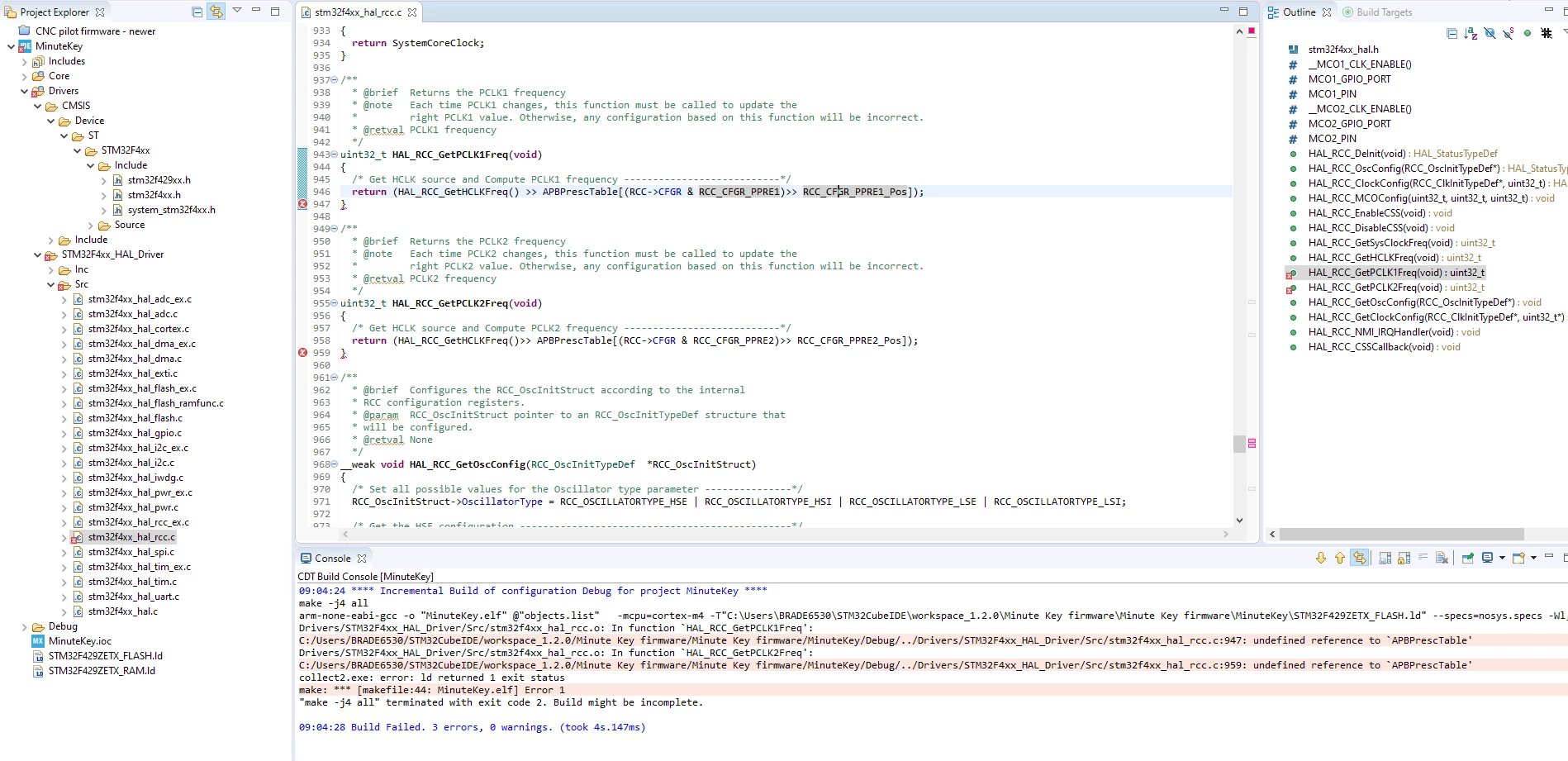

    0690X00000By1OcQAJ.png0690X00000By1OSQAZ.png0690X00000By1O8QAJ.png​Here is the information you have asked for.
    If you need anything else let me know.

    As I stated there is a declaration in the .h file. But there is no table in any .c file loaded when loading the IDE.
    This is code generated from loading the STM32CubeIDE version 1.2.1
    I am concerned that the versions. The ICON that was generated shows 1.2.0, when opening the splash screen shows 1.2.1, the about shows 1.0.0.201904021149. All I have done is down load the IDE and installed it.

    The linker can't get closure because you're missing source files.
    The array in question is in system_stm32f4xx.c , isn't it?

    That is the issue I stated. It is in the .h (declared) but no table (the table is not in any .C file) of what the IDE loaded.
    All the information of which file the error is, the error it self, the project search of the table is in the reply to berendi.

    The include file lays the groundwork, it is not where the variable is defined. The error you posted is most definitely from the linker.
    Find where you put the Repository and fish it out (alternatively download and unpack CubeF4 package)
    STM32Cube_FW_F4_V1.24.2\Projects\STM32446E-Nucleo\Examples\GPIO\GPIO_IOToggle\Src\system_stm32f4xx.c

    Yes it is from the linker. Yes the variable declaration is normally in the include file (.h). And Yes I have the system_stm32f4xx.c loaded by the ST install.
    However, this "system_stm32f4xx.c" that was loaded by the standard install does not define the table as I stated. There is only the AHBPrescTable[16] table defined in "system_stm32f4xx.c" the APBPrescTable[8] is not defined in the file loaded by the ST auto install. The linker is looking for APBPrescTable[8]. Can you tell me why the standard install did not get the correct .c file. I can not remember that I did anything other than tell it to install the IDE.
