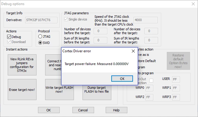

I got ''Target power failure'' error when I built a project
Posted on April 12, 2018 at 04:45
I bought a development board -STM3210C-SK/RAIS [Development Boards & Kits - ARM Raisonance]. I intalled the Ride 7 from the CD in the package, set up and confirmed all jumpers then opened an example - QuickStart_STM32F After I clicked the Project -> Build Project command, there is an error saying that ''Target power failure: Measured 0.000000V.

The error:

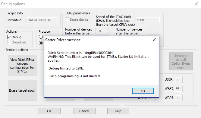

In Debug options window, if I clicked
“Connect to Debugger�?, then:
I assume that the board has already connected with my computer.

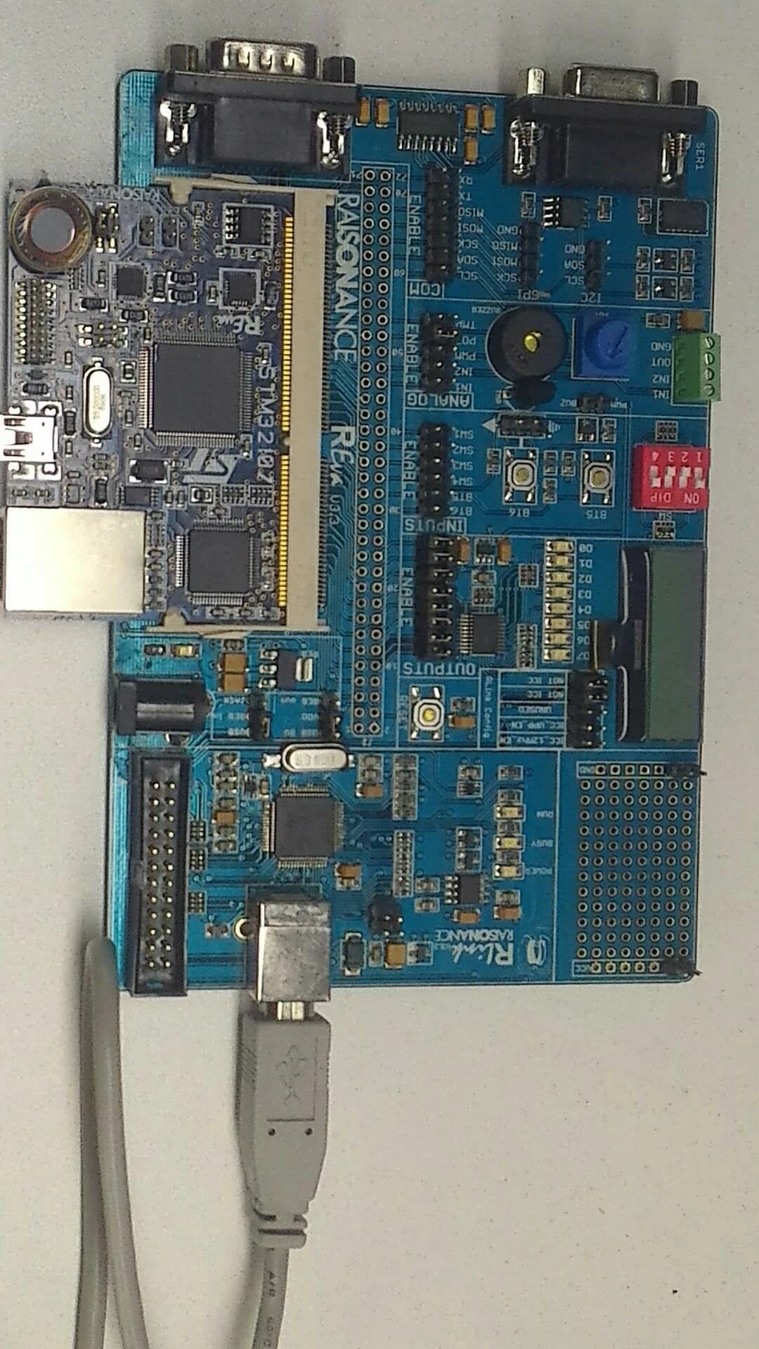

This is my board:

    But to your issue - might it be that the target is really not powered ?
    Not sure if the Raisonance debug pod can power a target, but surely not such a large one as depicted.
    Check the dev board manual for power supply options, and supply it externally.

    Thank you very much. Actually there is another cable to connect to the daughter board from computer. I didn't connect it in the picture. But it's no help. No matter it is connected or not, there is always such error. I changed to a new cable but it doesn't work. I thought about supplying it externally but I couldn't find a manual in anywhere (CD or paper or website). I'm now thinking to return the board and get money back. Thanks anyway.

    I'm pretty sure there are status LEDs on this board, at least for 'power on'.
    And there might jumpers to set, to select a power supply option.
    If ther is no LED at all on, it is suspicious.
