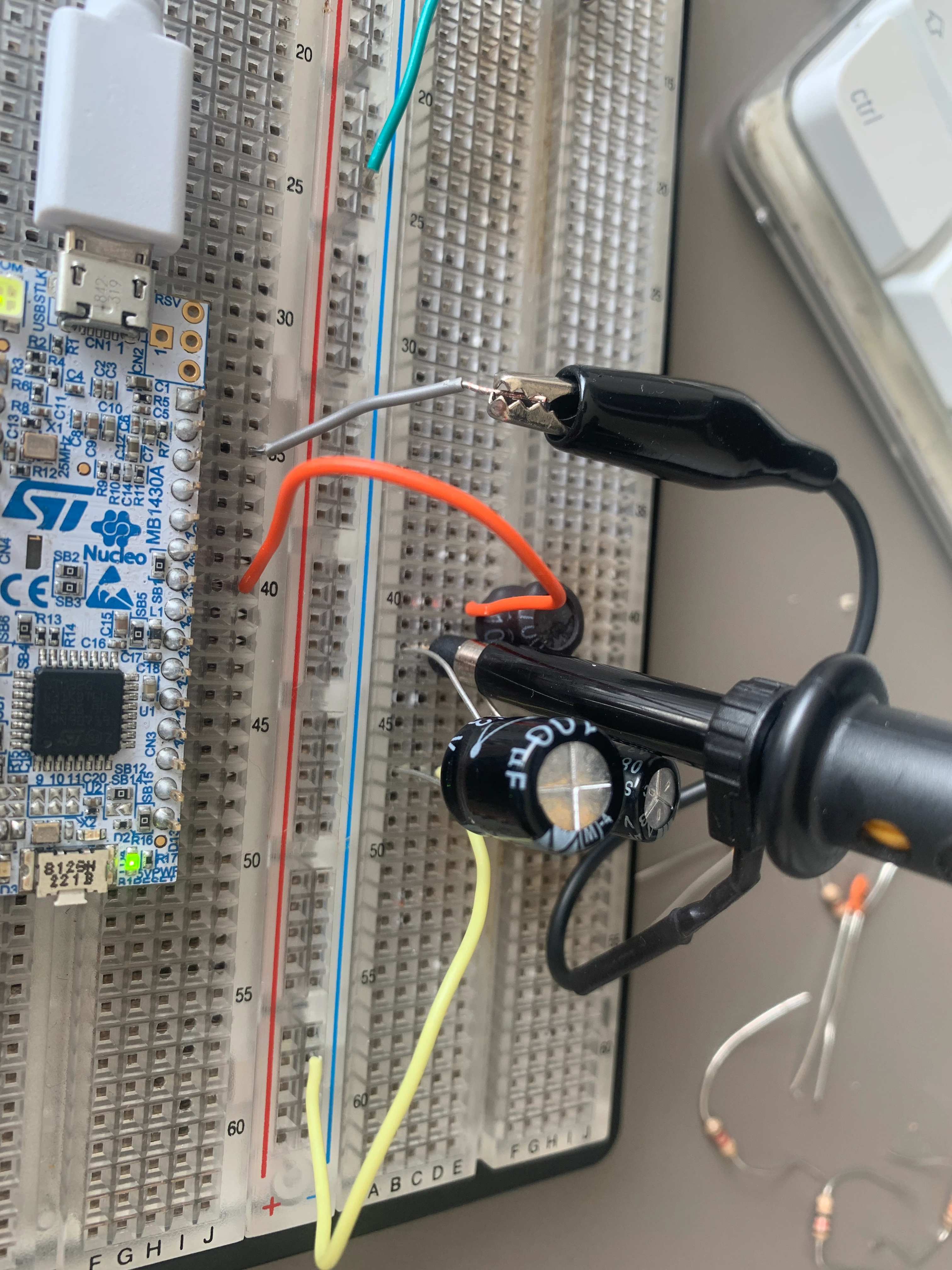

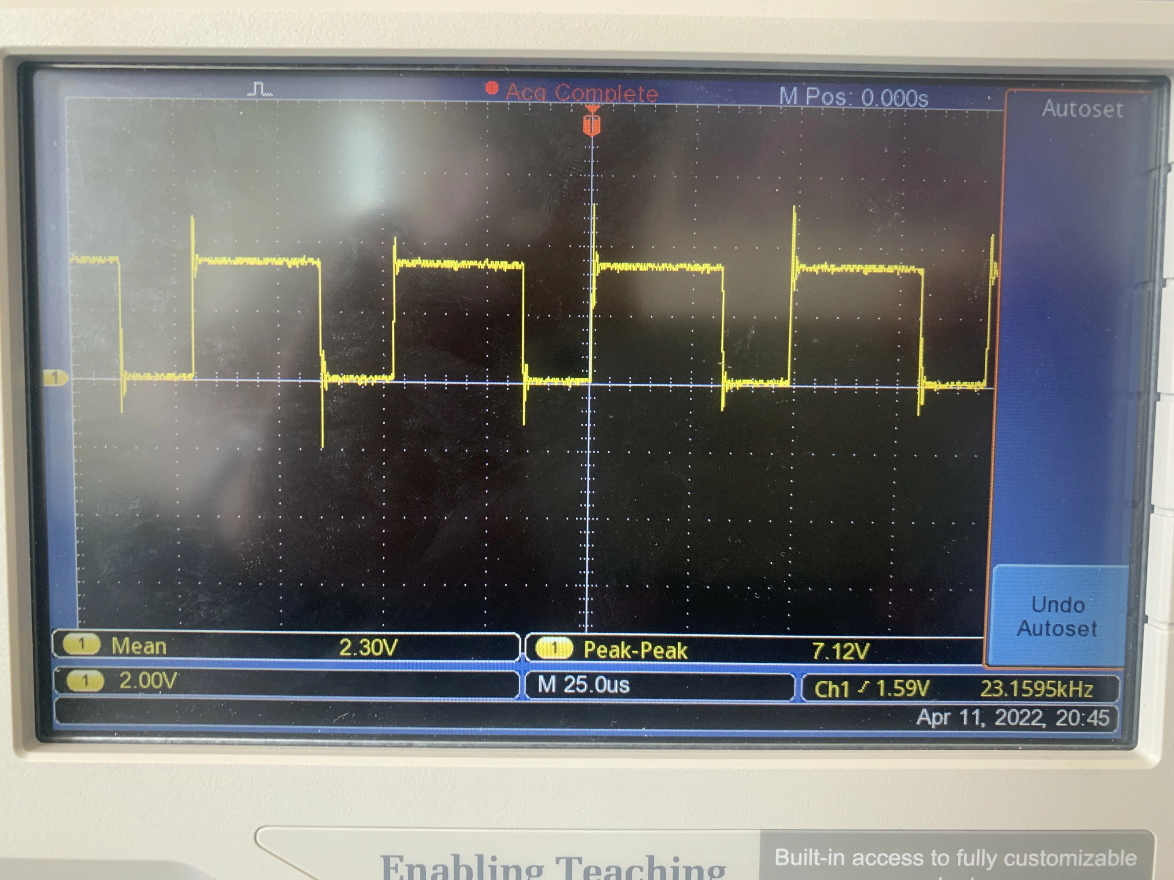

I generate a PWM signal on a pin going from duty cycle 0 to 100 and back to 0% to generate a sine wave using an LC Filter. When I connect the LC filter, the output is still an PWM with some spikes. C = 147µF L = 47µH f = 1,91 kHz
How exactly?

It's the same underlying issue as the other one. The STM32 isn't outputting the spikes, it's an artifact of how you're measuring.
Probably wise to reduce GPIO speed to mask some of the effect.
MM..1
April 11, 2022
You disconnect something ... Too maybe you need learn I=U/R (pin can drive only limited current)
Normal PWM use RC not LC .
