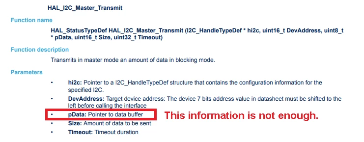

I don't understand how to use the HAL_I2C_Master_Transmit function. RTC DS3231
I am using I2C to transfer data from STM32F4 to DS3231 Real Time Clock registers.
HAL_I2C_Master_Transmit(I2C_HandleTypeDef *hi2c, uint16_t DevAddress, uint8_t *pData, uint16_t Size, uint32_t Timeout)
*hi2c - I2C structure
DevAddress - Device address
*pData - I don't understand this parameter.
It is written on the Internet that this is a pointer for data, but this pointer is used to transfer the register address in the Slave device.
Size - data size in Bytes.
What parameter should the data be passed?

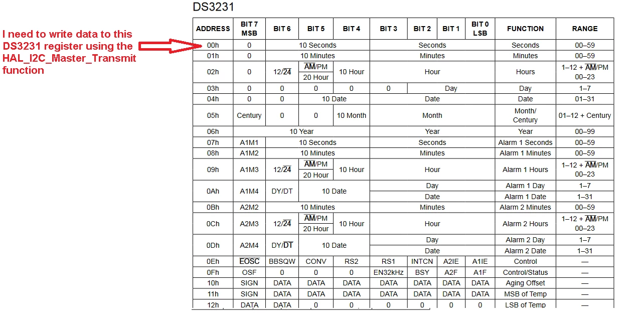

int main()
uint8_t RegisterAddress=0x0;
HAL_I2C_Master_Transmit(&hi2c1, 0xD0, &RegisterAddress, 1, 1000 );
I think that something is wrong with the &RegisterAddress parameter, but I don’t understand how it will be right.
As a result, I need to write data to the I2C Slave Device at the address I chose.

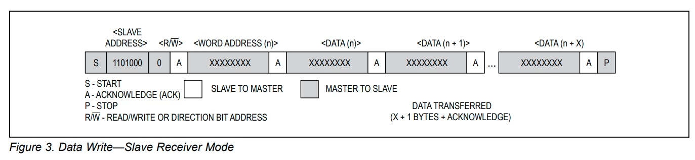

Yes, you can also use HAL_I2C_Master_Transmit. It expects the address first, then the data, so you need a buffer with that in it, and then send all bytes.
So to write the value 42 to address 0:
uint8_t data[2] = {0, 42};
HAL_I2C_Master_Transmit(&hi2c1, 0xD0, &data, 2, 1000);

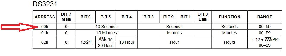

In this code, data is passed through the *pData parameter.
And how does the HAL_I2C_Master_Transmit function know at what address this data should be written?
DevAddress(second parameter) - is the address of the I2C Slave Device, not the address where data should be written to.
The address for the register that contains seconds in the DS3231 is 0x0.

TDKBest answer
August 17, 2023
