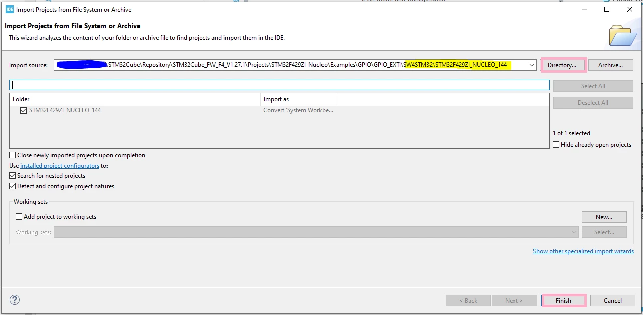

Hello @Koseo.1 ,
I think the "Directory" is wrong. You need to import only the project you have chosen in the STM32Cubeexpansion.
Please try to used this directory when you import your project stm32 extension package\Projects\Nucleo-H743ZI\Applications\STL\Sxxxxxx\SW4STM32.

Hello @Koseo.1 ,
Concerning the System Workbench toolchain, called SW4STM32, is no more supported for all new series. For that I recommend you to use STM32CubeIDE.
In this case, and to open your project, I advise you to follow these steps:
1- Open STM32CubeIDE
2-Click File-->open projects from file system or Archive
3-Import source as shown in the below figure
4-Build the project
I think this user manual can help you Migration guide from System Workbench to STM32CubeIDE - User manual.

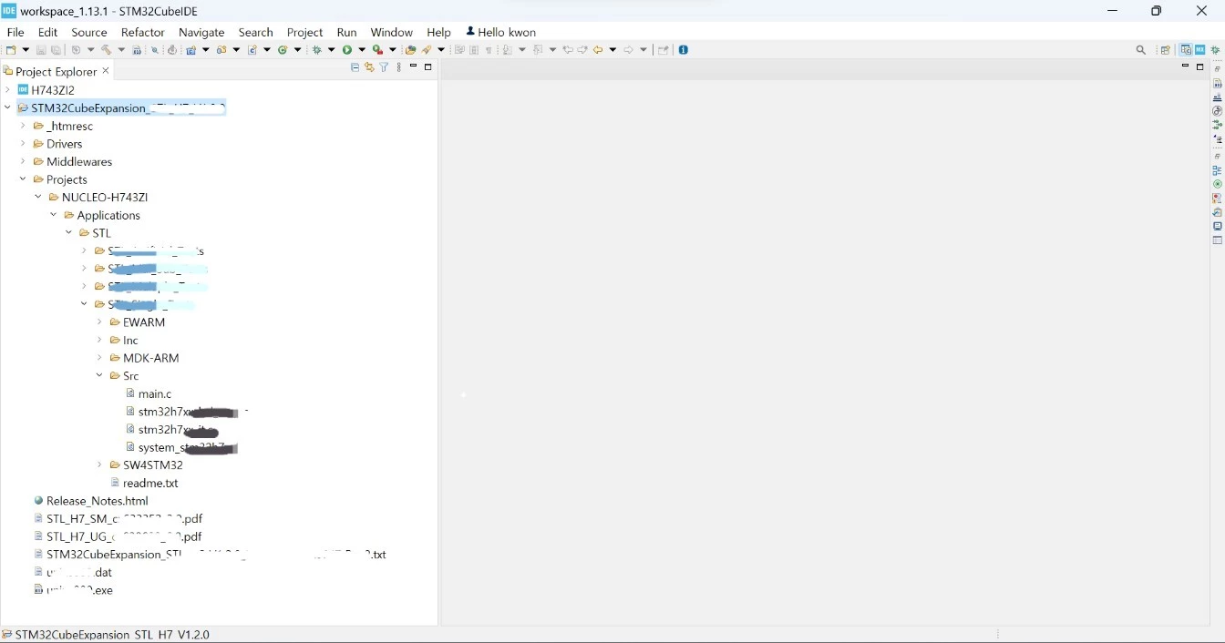

Koseo.1Author
September 15, 2023
Hello.
I checked what you sent me.
As you said, we succeeded in putting the project on Project Explorer.
But I haven't been able to build since.
And I attached the picture below, but the project build (hammer picture) you mentioned is not working.

Koseo.1
Koseo.1Author
September 15, 2023
I was surprised because the reply was fast.
But there is a reason why I added the STM32CubeExpansion_xxxx folder itself as shown in the picture.
First of all, it was because I added the STM32CubeExpansion_xxxx folder itself as shown in the picture I attached in the enclosed user guide.
And secondly, in the picture I posted, the user guide said that I need to use two versions of STL_Lib_product_x1.a and STL_Lib_product_x2.a in the STM32CubeExpansion_xxxxx folder -> Middlewares -> STM32_Safety->Lib folder.
I think the STM32CubeExpansion_xxxxx folder itself should go up, but I was wondering if I was wrong.
And you asked me to share the project, how should I share it?
As I wrote above, I'm careful because the pdf I copied together on the expansion package I downloaded says "ST Restricted - Subject to Non-Discovery Agreement – Do not copy".
