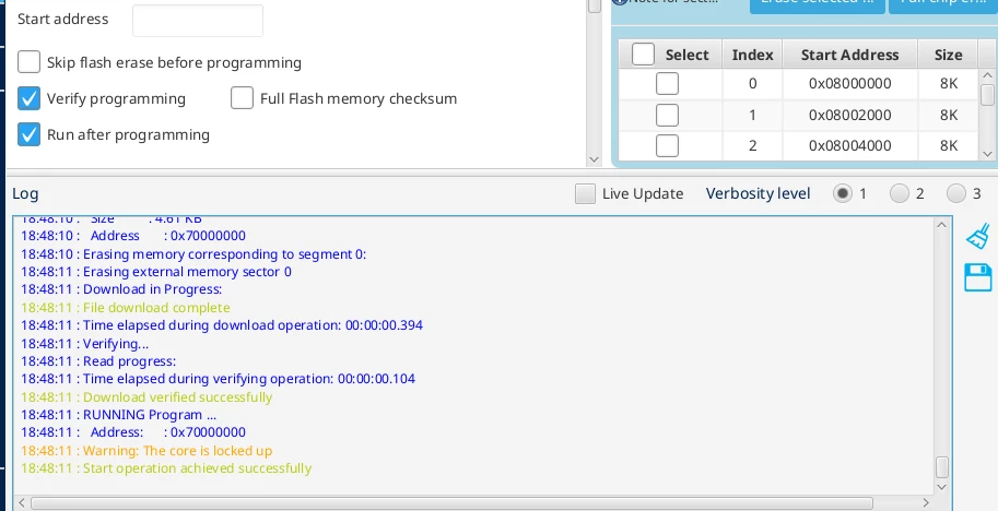

I am currently working on the STM32H7S78-DK board & after building GPIO demo present Example code from git repository of that STM32 provided, while flashing binary from the STM32 programmer I faced issue it is mentioned below
  • When code is flashed from STMcube programmer it sometimes flashed and sometimes showing error that , core is locked or core is under reset
  • When code flashed successfully , I did not get expected result (Ex. LEDs not blinking)
Can you please help me to resolve this error, I attached screen shots of errors below

Hello @amar_1 and welcome to the community,
Could you please share the option bytes sates and precisely product state?
Please look at this post Solved: Re: STM32H7S78-DK: Reset PRODUCT_STATE to OPEN - STMicroelectronics Community
Thank you;
