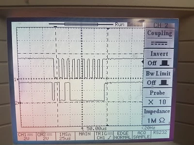

    Peter Curtis
    January 25, 2018
    Posted on January 25, 2018 at 10:38
    Hi Andrew,
    Thank you for your response.  Yes.  I hooked SDA/SCL up to a scope and checked out the signals.  The rise looked a bit woolly, so I reduced the pull-ups to 1K.
    Above shows the trace when running the IsDeviceReady() on 0xA0 (the CAT24C512).
    However, if I try to write to the device afterwards, It still fails to write.  Then the mem device appears to lock up - that is I get a not ready response if I try another IsDeviceReady().
    Not quite sure where to go with this at the moment.  I have an I2C bus analyser on the way, maybe that will shed more light - but I've never had to use one in the 10years of my using I2C on other controllers.

    Andrew Neil
    January 25, 2018
    Posted on January 25, 2018 at 12:25
    Can't your scope give you a screenshot directly?
    Verify that scope waveform against the I2C spec.
    • Is it a valid Start Condition?
    • Is the slave address correct?
    • is the R/W bit correct?
    • does the Slave ACK?
    Again, have you tried it on a known-good board (Nucleo, Disco, etc) with a known-good example for that board?
