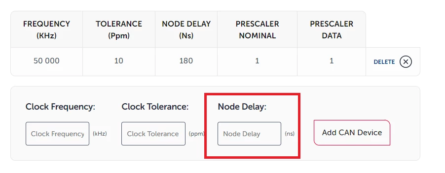

mƎALLEmBest answer
September 20, 2024
Hello @KDG ,
Watch this video on youtube, how to configure FDCAN timings especially @13:57
You need to use kvaser calculator from here: https://kvaser.com/support/calculators/can-fd-bit-timing-calculator/
Node delay to be put here:
LCE
Principal III
September 20, 2024
It's all in the reference manual, and register description. It's all calculated as "mtq".
And it depends on the actual transceiver chip, which has its delay in ns usually in its datasheet.
