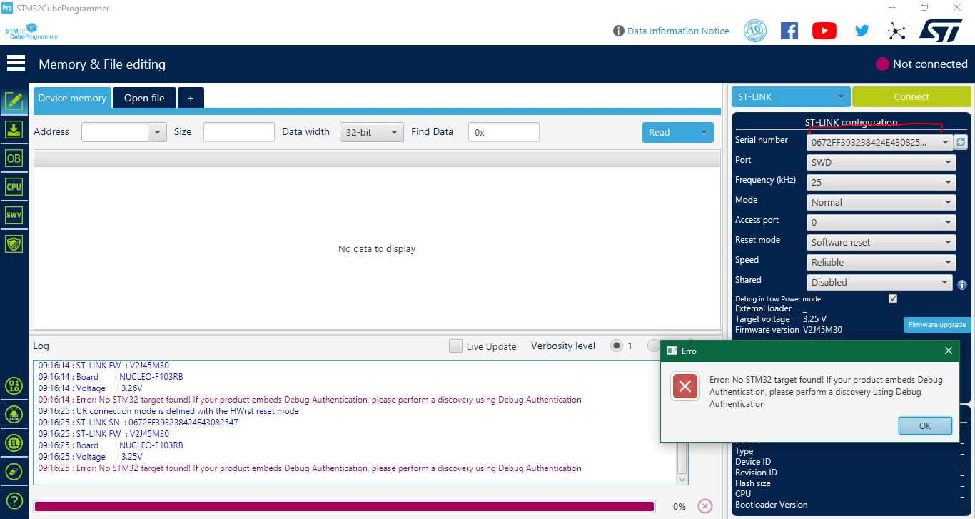

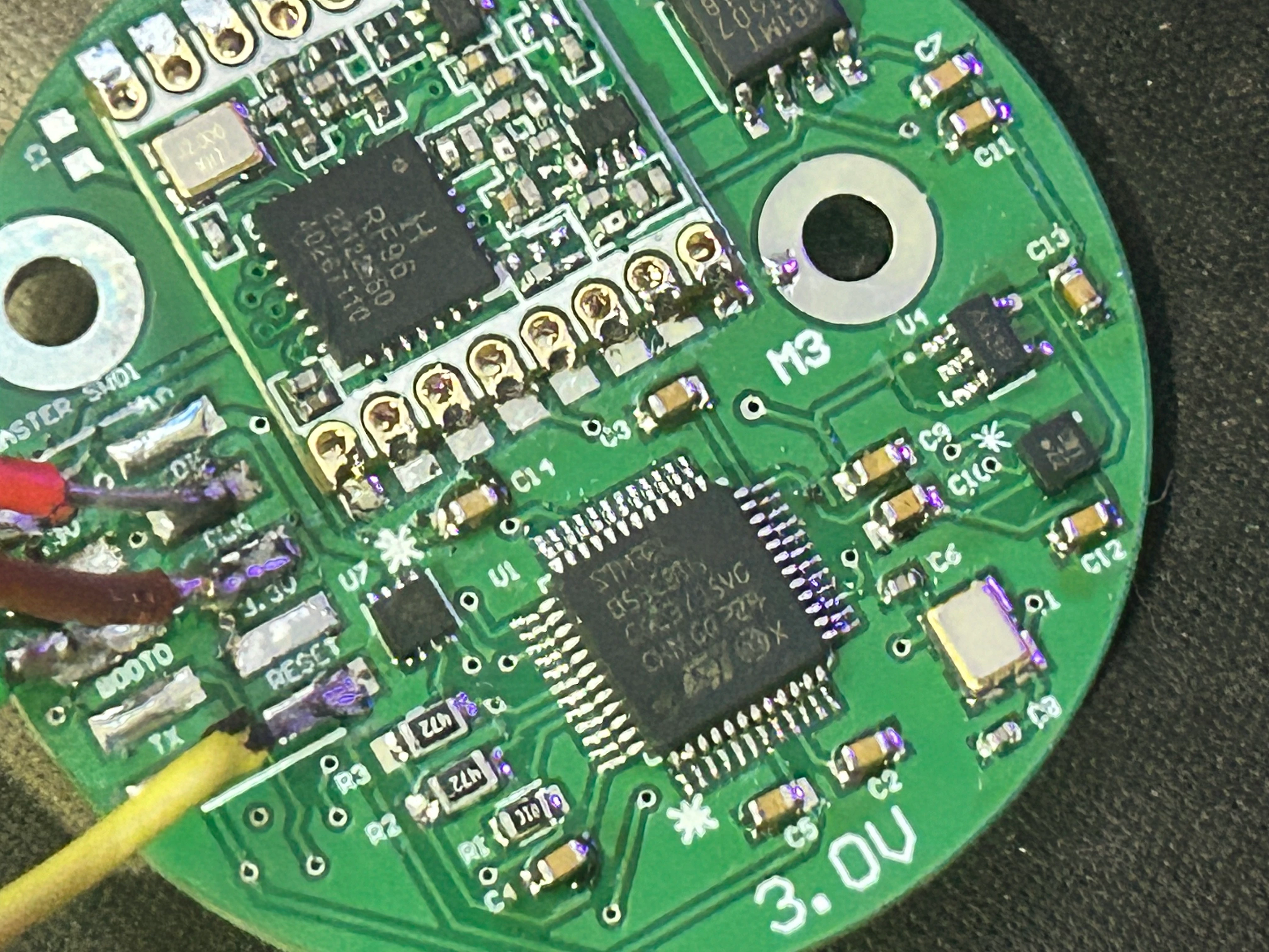

I can't connect my Nucleo to my STM32L0 board
Well, I'm new to the STM32. I'm developing vibration and temperature sensors, which used to be equipped with an atmega.
With the new demand for processing I decided to upgrade by putting an STM32L0 in place of the old controller.

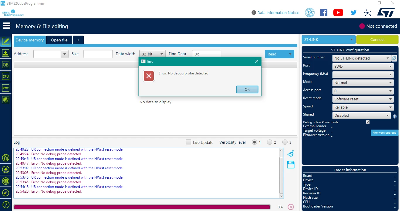

The problem is that now I can't use my CUBE Programmer to connect to my board via Nucleo's STM Link.
An error message appears whenever I click Connect, and my Nucleo board flashes red.
I think I may have made a connection or PCB design error.

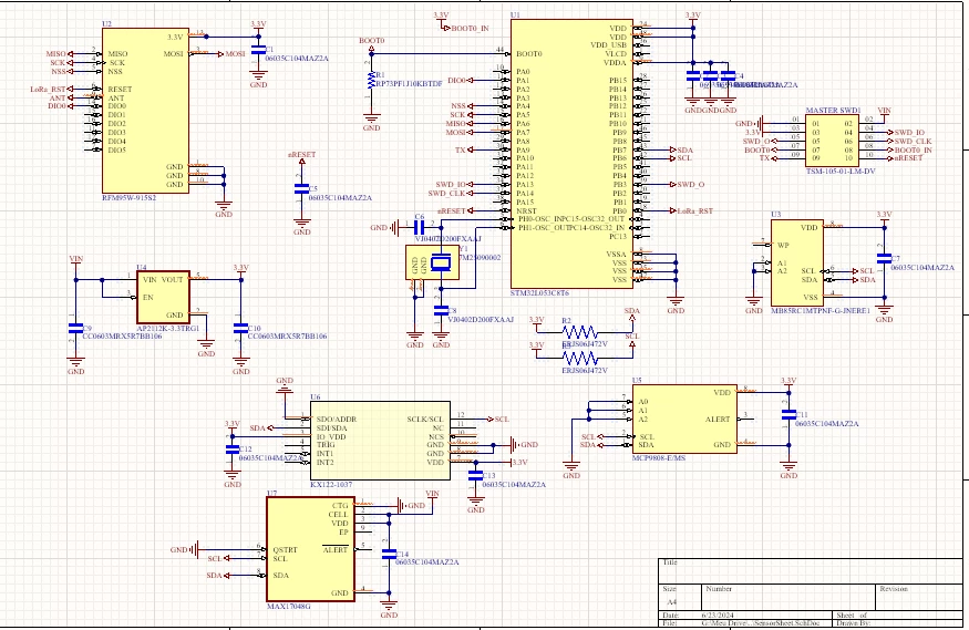

Information:
My system has 1 accelerometer 1 temperature sensor 1 Lora radio 1 battery sensor and a 3v3 regulator.
The clock has been set to 25KHz by means of an Oscillator Crystal.
and the BOOT0 pin is not connected to anything other than the pull-down resistor.

Ok, so now it sees the ST-LINK
The complaint is the target is not viable.
So power and connections become critical. Schematic looks reasonable. Check components and orientation. Common grounds. Check state/level of NRST signal
The target will need both analogue and digital supplies connected.
SWCLK, SWDIO, GND
The CM0(+) will not support PB3/SWO
Disconnect the local target on the NUCLEO-F103RB board, pair of jumpers.

The error is that it can't even find the ST-LINK / NUCLEO, so perhaps a short or power issue.
I'd assume you've used the NUCLEO previously? Which model of NUCLEO?
Does it show up in Device Manager?

I've used NUCLEO a few times, and it works perfectly. I made a new board soldering only the STM32 system and now my NUCLEO is showing up in the device manager and also in the Programmer.
However, I can't connect to it.
