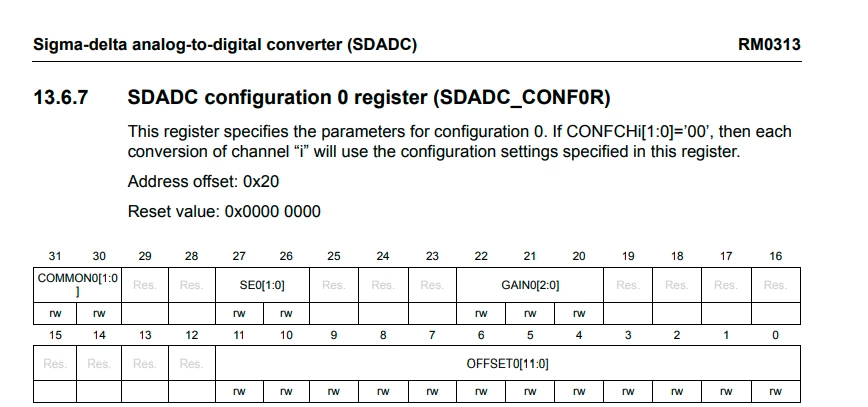

I want to change the SDADC gain while the MCU STM32F373VBTx is running.
That works, but only one time.
First, at the initialization of the SDADC, the STM32 CubeMX set the predefined gain.
Second, I set the gain by reading values from variables. That works.
But when I do that at the third time, nothing happens. Hmm...Why?
Is it something I need to wait for, until I can se the gain?
One question more. Does the calibration function HAL_SDADC_CalibrationStart find the perfect offset, so I don't need to change it manually?

Best answer by waclawek.jan
> hsdadc->Instance->CONF0R |= SDADC_gain << 20;
Where are the GAIN bits zeroed?
2 replies
waclawek.jan
waclawek.janBest answer
August 20, 2021
DMårtAuthor
Lead
August 20, 2021
No!
I will try that!
Thank you.
Edit:
Now it's working. I have ever worked with register programming for STM32 before. This is something new for me. Quite fun.
hsdadc->Instance->CONF0R &= ~(0b111 << 20); /* Clear */
hsdadc->Instance->CONF0R |= SDADC_gain << 20; /* Bits 22:20 GAIN0[2:0]: */
