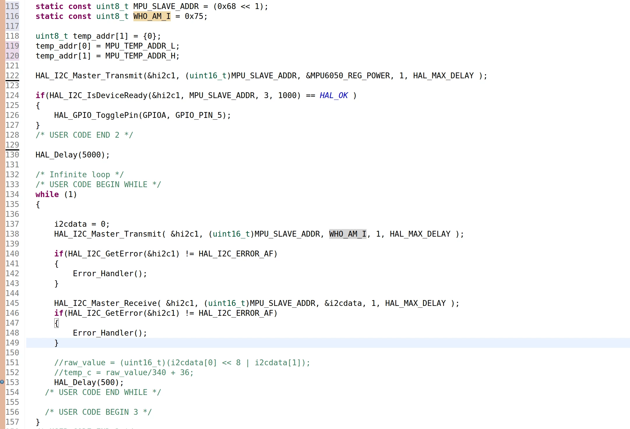

I can not read I2C data although I get HAL_OK value from HAL_I2C_IsDeviceReady() function.
Hi Everyone,
I am trying to read temperature value from MPU6050 sensor. I could not read it. I tried to read WHO_AM_I signal, I could'nt read it as well. Value should be 114 but i am getting 5.
Does anyone has any idea what to check, how to fix? I am using STM32 Nucleo board.

Problem is solved, I didnt wake slave up correctly.
