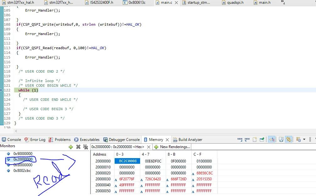

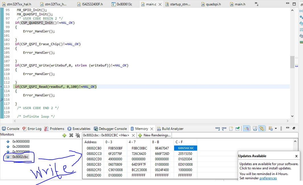

Now i have working in Image processing project . Forst i tried to uplad the code for normal flash memory but array size is big so memry is overflow .After i move QSPI external flash memory .
I have write the code is working fine but one specific doubt
my External memory region is 0xC000000 but my write data store 0x80002cbc and read data is 0x2000000 region
I send code and snap so anyone give the solution

8 replies
Yugenthar
YugentharAuthor
May 10, 2023
Sorry External Memory region:0x90000000 not 0xC0000000
SKacp.1
May 10, 2023
You assign pointer do the string in Your Flash memory so the string is located in the Flash at address 0x80002cbc. Next You read to the buffer which is located in the RAM. That's all.

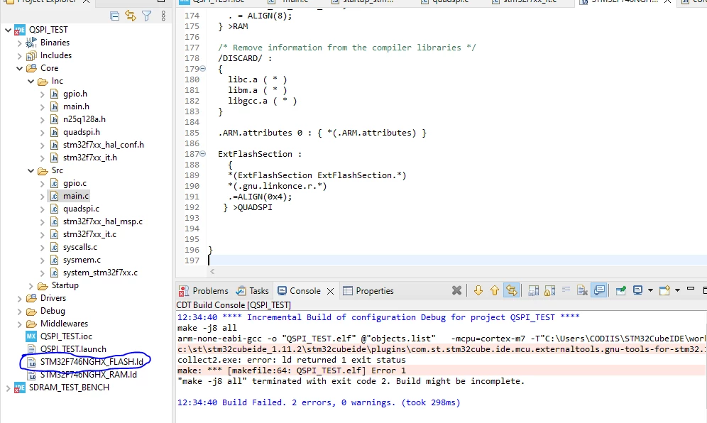

Yugenthar
YugentharAuthor
May 10, 2023
Thank you sir.

 .ARM.attributes 0 : { *(.ARM.attributes) }
 ExtFlashSection : // i am adding this five line but is error
 *(ExtFlashSection ExtFlashSection.*)
 *(.gnu.linkonce.r.*)
 .=ALIGN(0x4);
 } >QUADSPI

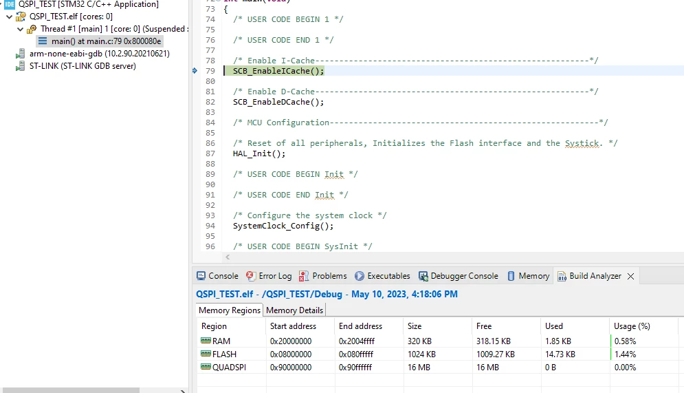

have one doubt sir ..how to write the QSPI external flash Actually I am configure the stm32f746dico board in build MT25QL128ABA1EW9-0SIT IC chip but is not working fine ..
First of all I have write the QSPI program and debug the program but not show QSPI memory window then I have write the flash id but is show error .I have send the program and snap pls give your support and help
