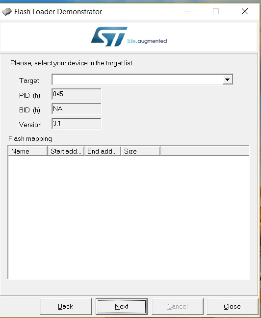

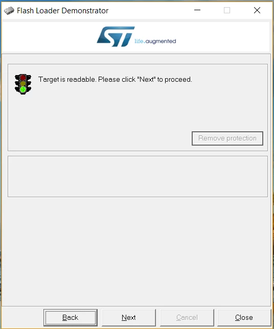

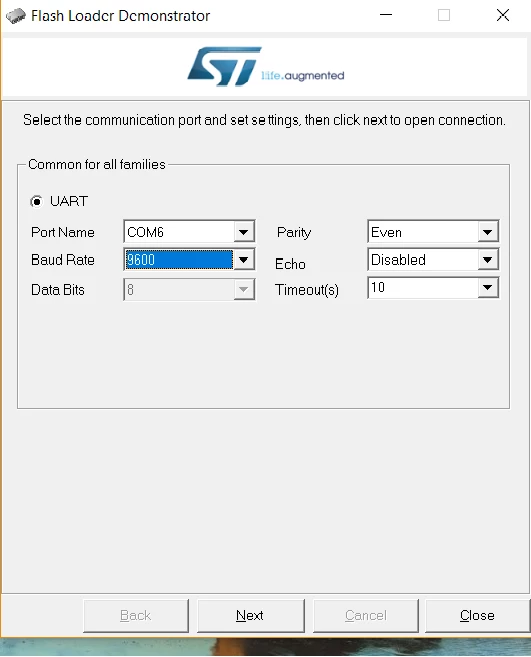

I am working with STM32F767ZI Nucleo evalution board.When i tried to communicate with stm32 flash demonstrator gui version 2.8,evaluation board is not recognized by the demonstrator.Please suggest some solutions. It shows addresss is not allowed.

    Tried how? Your screen shots, while interesting, don't tell be much about the STM32 end of the issue.
    And what USART are you connecting too and how?
    You're using BOOT0=High to get into the System Loader?
    According to the documentation the VCP uses USART3 PD8/PD9, and that's not supported by the System Loader.
    Can you use the ST-LINK?
    Can you use the User USB and DFU mode?
    AN2606

    Thank you for your reply,
    I am using USART1 PA10/PA9 with serial to USB converter according to AN2606.
    Yes. I have connected BOOT0 pin high.

    The new STM32CUBE Programmer app also supports USART connectivity.​
