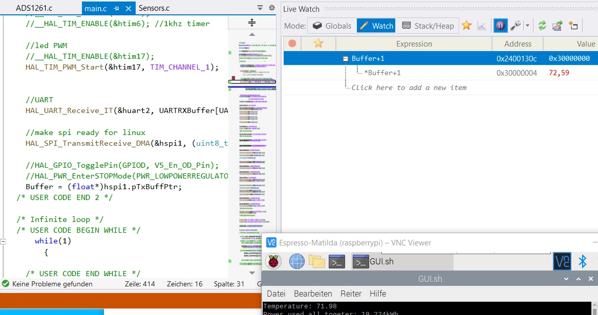

if I am watching the TXBuffer, there actually is the correct value inside and it changes with time. The first value I got was another than I could see in the buffer (it was the old one from the last time I used SPI)
_legacyfs_online_stmicro_images_0693W00000bizADQAY.pngI also use the CS pin as an interrupt source ,and also tried this (I think this is the part you are referring to)

Hi, I read the part, that is why I am disabling and enabling the SPI. I am using the HAL_macro __HAL_SPI_ENABLE(&hspi1), but it is the same as setting and resetting the SPE bit.
During the transfer I am transferring 84 Byte, the temperature I am referring to is a float and it is located on Byte 4-7, so the 2 byte buffer you are writing about could not really have an effect, even if it is not flushed with the SPE bit.

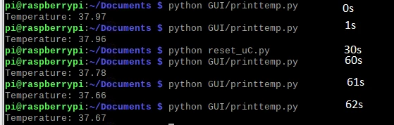

Some additional information.
I tried to following to make sure it is a problem I am having with the microcontroller and not the raspberry.
I heated the element a bit, so that it cools down to have a decreasing temperature. The values I get have a noise in the range of 10mK, so two consecutive measurements only differ by 0.01.
I took two measurements to make sure I got the real temperature. Then I waited ~30s and resetted the microcontroller. After additional ~30s I read the temperature two times. The first temperature I got was between the first one and the last one. This somehow prooves that I got the value from when the micocontroller was resetted.
