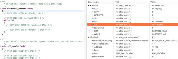

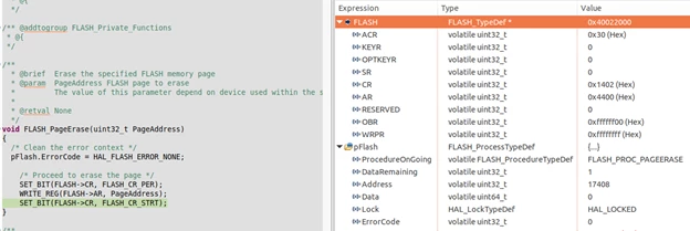

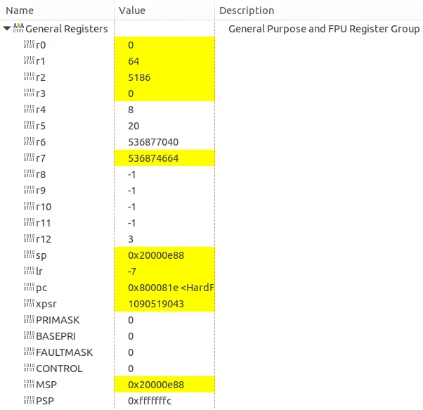

I am attaching some screenshots of the FLASH registers and the CPU register immediately before and after a sample hard fault.
Flash registers just before hard fault.
CPU registers just before hard fault.
FLASH registers just after hard fault.
CPU registers just after hard fault.
Any help will be greatly appreciated. Thank you.

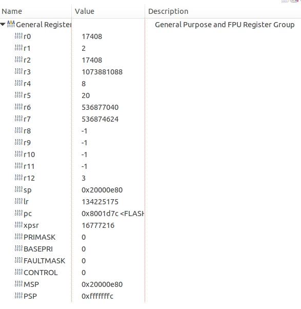

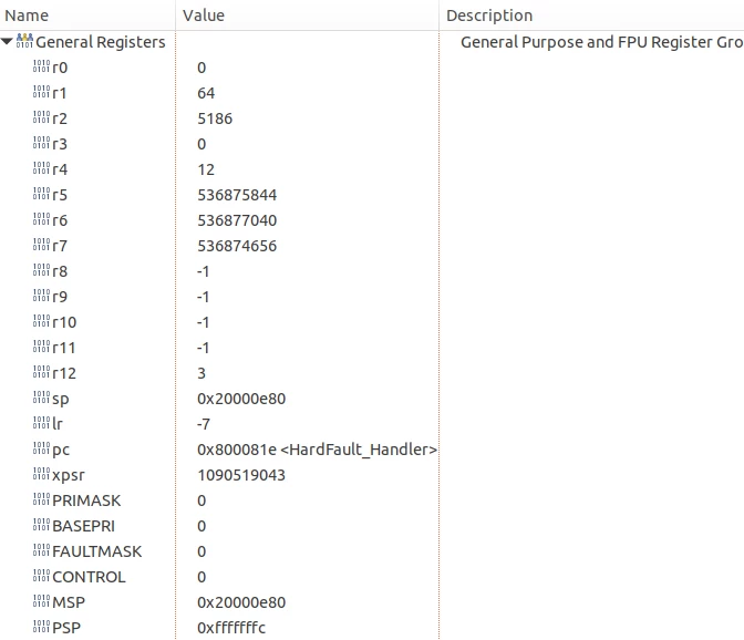

I apologize. My images show FLASH->AR as 0x4400, which is the offset into flash, not the page address. I just re-ran with FLASH->AR as 0x08004400 and got the same hard fault. There is no change before the fault except for FLASH->AR. After the hardfault, the FLASH registers are the same (except AR), but the processor registers are different. Here they are. I apologize for the confusion.

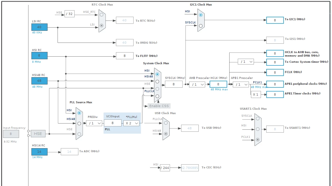

Here are the clocks.
