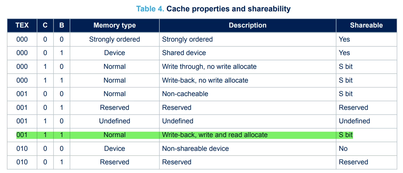

I am using an STM32H747 - (in an Arduino Portenta) - share data between cores in SDRAM
The SDRAM is 8MB, and starts at 0x60000000
I would like o share the first 1MB between the M4 and the M7 cores

I would like to know if the code above is the correct way to set up the shareable region.

Hello @RSala.1​
Could you explain why you disable the configuration of TEX field level.  This parameter can be The TEX, C and B bits are used to define cache properties for the region, and to some extent, its shareability. They are encoded as per the following table as referenced in AN4838.
