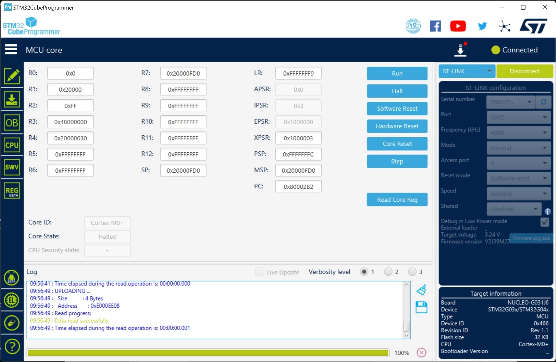

0693W00000WLFIKQA5.jpg080002ae <HardFault_Handler>:
 * @brief This function handles Hard fault interrupt.
void HardFault_Handler(void)
 80002ae: b580    push {r7, lr}
 80002b0: af00    add r7, sp, #0
 /* USER CODE BEGIN HardFault_IRQn 0 */
 /* USER CODE END HardFault_IRQn 0 */
 while (1)
 80002b2: e7fe    b.n 80002b2 <HardFault_Handler+0x4>
BBrow.2
BBrow.2Author
December 18, 2022
Stepping it from RESET shows it stops at the GPIO command (str - 800024a)
 GPIOA->ODR = 0xFF;
 8000244: 2390    movs r3, #144 ; 0x90
 8000246: 05db    lsls r3, r3, #23
 8000248: 22ff    movs r2, #255 ; 0xff
 800024a: 615a    str r2, [r3, #20]
//  GPIOA->
R3 appears to be correct (48000000 is GPIOA address, 20 more is ODR address)

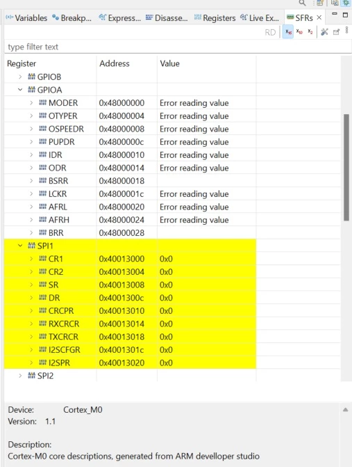

BBrow.2
BBrow.2Author
December 18, 2022
More specifically, GPIO is on AHB2 (Nothing else on AHB2), so it would seem that there is some kind of issue with AHB2 access.
BBrow.2
BBrow.2Author
December 18, 2022
0693W00000WLFJmQAP.jpgCube IDE debug
BBrow.2
BBrow.2Author
December 18, 2022
Even using:-
*((uint32_t *)addr) = 0xff;
if addr = 0x40020000 (AHB1) no problem
if addr = 0x48000000(AHB2) HARD FAULT
